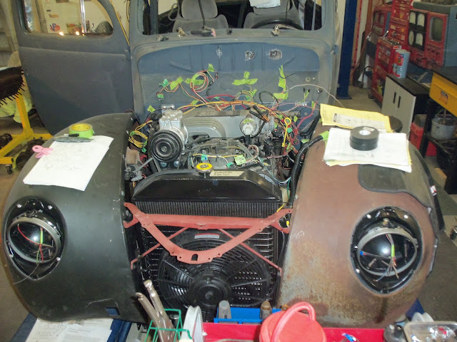

Back to the wiring. We all know how important grounds are and how they can **** up hours of troubleshooting...so I bought an engine to frame cable:
And rigged up a short battery to body cable, which will add a redundant ground to the system:
Also grabbed a 12V power source socket to charge whatever is needed. It will likely go in the console.
Behind the dash, things are slowly getting cleaned up, labelled and checked:
There a whack of wires coming from the door opener system that have to be coiled up, tied back and hidden:
Tomorrow it'll be mostly wiring, trying to get it into a "RUN" situation.

A couple of tips on wiring the EEC Harness.
The "inertia switch" is not really required. It was a safety item to cut off power to the fuel pump in an accident. Since most accidents cause the engine to stall, the EEC will turn off the fuel pump anyway. If you do use one, be carefully how you physically mount it. I know of one guy who mounted it too close to where the trunk latch was located and every time he slammed the trunk, the switch would trip !
The item labeled "Idle Speed Sensor" is actually the Idle Air Controller (IAC) or, as I call it the Idle Air Bypass Valve.
Your diagram only shows one connection from the power relay to the EEC, but I am certain there are more than that. Run separate wires from the module to the relay.
Likewise, there are multiple ground pins on the module. Run separate wires from the module to the battery ground post or a junction point close to the battery.
The diagram does not show how the A/C connections are wired. One is somehow connected to the A/C on/off switch (likely after any A/C safety switches). The other somehow control an A/C system cutoff. You could probably ignore these without any problems.
Remember, factory splices only required 2 wraps of bared copper and were cover by a couple of turns of friction tape (you would call that hockey stick tape). The whole harness was covered in either convoluted plastic tubing or non-adhesive PVC electrical tape. Friction tape was used to terminate either the non-adhesive tape or convoluted tubing.
Pack all connectors with silicone dielectric grease.
One more thing. I hate fuse links ! Use a good quality weatherproof inline fuses holder.

Good timing OldWiz - here's me right now (live action shots from the E-tek Shop!!):
Just finished stripping the harnesseseses.....now I can start whittling them down to what's actually needed and what's (hopefully!) not.
-----> For anyone that has done an EFI engine transplant with the STOCK harness retained and an aftermarket (Painless/IAS) harness inside....see my seperate EFI transplant thread (below) to give advice - rather than get this one WAY muddled. Thanks!!

After stripping all the tape and corrugated tubing, I could finally see what went were and what color the wires are:
The rest of the afternoon was spent tracing and labeling all the wires and finding where they terminated, plus which pin they originated from on the EEC.
OK - the wiring photo's maybe aren't as exciting as welding and painting, but nothing runs until this part is all sorted out - so onward!
You are doing it the right way ! Aftermarket harness for the EEC system are not worth the cost, if you are using the stock PCM and al of the stock sensors and actuator.
I would redo the insulation on splices like the one in the picture with 3M 1755 friction tape or, if you want to be fancy, 3M 130 linerless rubber splicing tape. Don't waste your time with solder or crimp connectors when shortening/lengthening parts of the harness. Strip enough insulation to get 2 full turns of bare copper.
This is best deal I have found on Non-Adhesive Vinyl Harness Tape. Finish with 3M linerless splicing tape.
Ignore A/C connections to the PCM.
Use inline weatherproof fuse holders instead of fusible links.
Run all grounds to a point close to the battery. The PCM housing should be grounded to the chassis via the mounting bracket.
You have a god start ! If you didn't live a million miles from NOWHERE I would be there to give you a hand in exchange for a couple of beers !
EDIT: It is called "convoluted tubing".

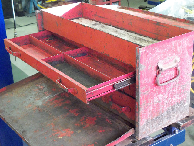

GJ member Winnipegtibook (Brian) sent me a vintage Snap On box he acquired for restoration. I'll put a few pics of it here (and maybe a few in the toolbox restoration thread), but the majority will be on my blog.
Got the box torn down today and cleaned up the drawers and sliders in the parts washer. Had to drill out a couple rivets to get a couple of the sliders out. 2 hours.
Drawer liners were made from an amateur painters work...maybe the original owners wife? LOL!
Pretty rust on the bottom and very rough around the edges....

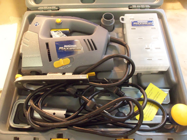

Tried out this Mastercraft Maximum (really nice quality) serpentine scroll/jig saw I bought from the neighbor last summer:
None of the bits had even been used!
Has some very nice features:
Anyways, I used it to finish the cuts I made with the skill saw - but it didn't cut as clean or as straight as a regular Jig Saw. Would be better suited to cutting circles or for plunge cuts.
