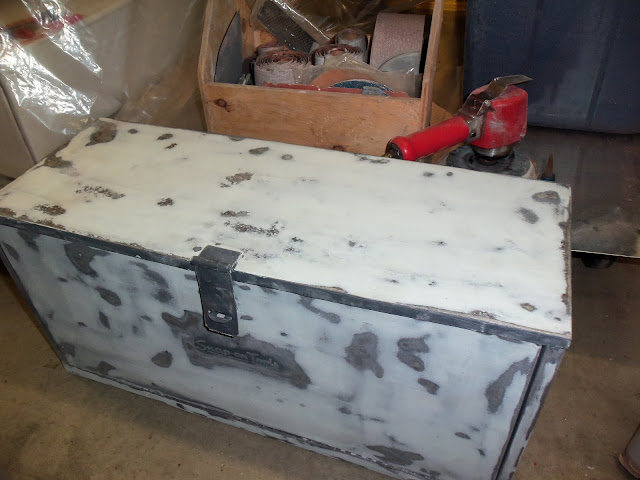

The tool box came up nicely.
What your choice for regular and high build primer ?The top was very rusty as well. I put a lot of primer on it and hope to be able to sand most of it out - otherwise I'll have to put a little high-build on it...
Last year, Clausen's sent me a sample of their "All-U-Need" 2K primer filler - it's really an awesome product. Goes on over anything, fills like crazy with no shrinkage and sands so easily it silly.
Between what you said and their claims, why would you use any things else, except for small jobs where a rattle can is more appropriate ?
