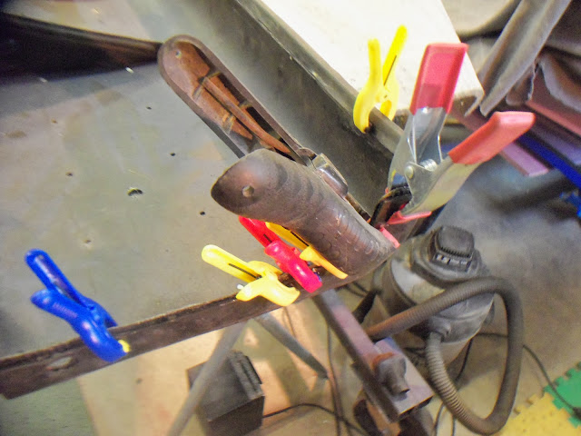

OK, here we go!

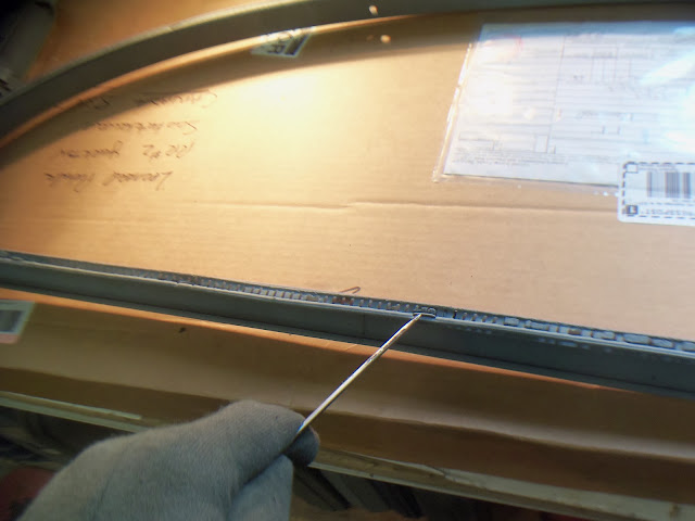

I was finally getting to gluing the running boards, but when I began to rough them up I started looking at the indents from the brackets and wanted to be sure they didn't show through the rubber matting down the road.
I'm sure they showed when the car was new, but that was a different time - and a different car. It just wasn't going to fly now....
Then I noticed that one running board's edge was de-arched....d'Oh!
So after trying a few different things, I ended up with this arrangement:
A little heat - and Violoa!
So - after all that, here's how they ended up... Once again - better right than sorry!

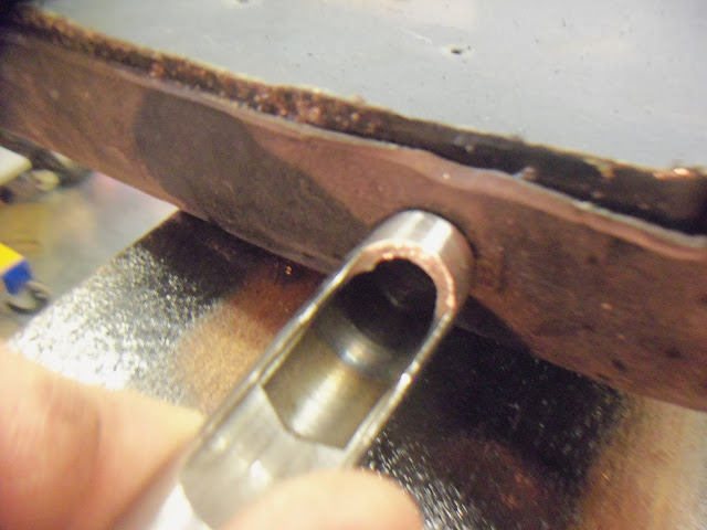

Opening up and gluing down the bolt-holes in edges of running boards:

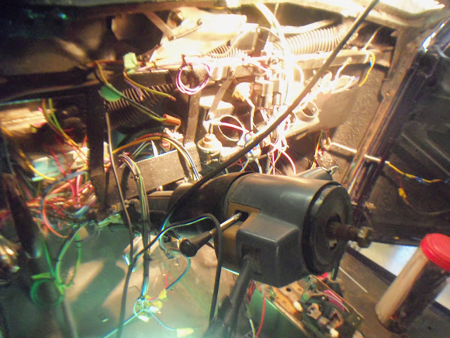

Did some wiring on the the dash and harness, fitting of the stereo into console base and some other items....pics to follow....

Spent some time today getting the dash and HVAC wiring, as well as the vacuum tubing sorted -
First up was fabbing up a bracket to mount the Fuse Block to -
Although I had gone through the Vintage Air wiring and vacuum line system on mock up, I still had to finalize some things, like final mounting of the the relays, routing everything cleanly and double-checking connections -
May not look it - but this is all cleaned up!
Bought this much nicer looking loom to use instead of that plastic ****...
Should look good in the engine bay too -

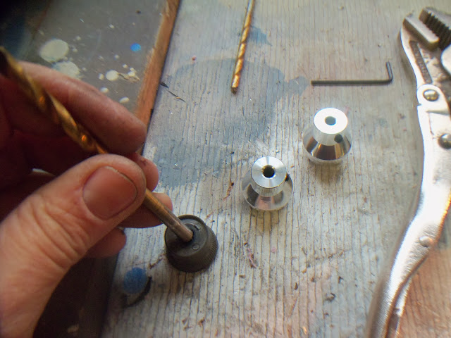

Re-installed the dash today, found the aftermarket knobs needed to be sized:
Used a drill to match the shaft size:
Use electrical tape and soft glove for protection in the drill vise:

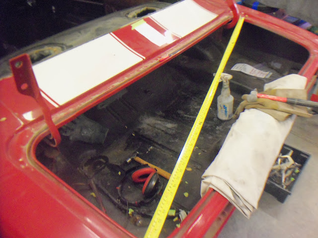

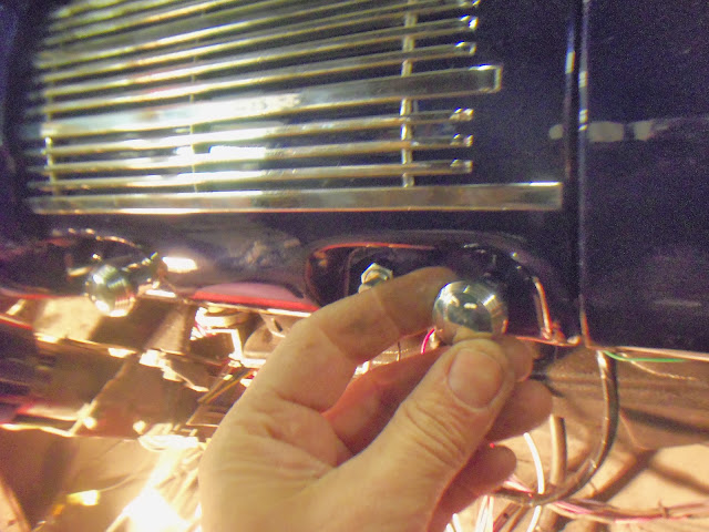

Ever have "one of those" days? Today I went to isntall the chin piece today on the 40 Ford and because the entire grille, plus both fenders all come together here, I had one HELL of a time lining it up and getting my hands and tools in there! As well, one of the tools that would have really helped - my 7/16" ratcheting box wrench - was NO WHERE to be found....GERRRRR!
Anyways, after WAY TO MUCH time and CUSSING, I finally got it (mostly) done. I say mostly because 2 holes still won't line up!
It seems to be lined up reasonably well, but there's holes on either end that will just not line up....
Crowning jewel -
