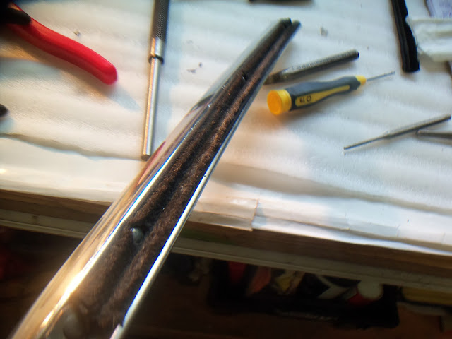

After our first @*$&^%(@#! snowfall of the year I got side-tracked with shovelling, putting out the heated mats around my hot tub and giving the 'new' snowblower a tune-up before using it. I changed the oil, removed the old gas from the carb, cleaned and gapped the plug and then gave 'er hell. After 12 years in Saskatoon without a blower, it was a DAMN nice change from shovelling! :)
Anyways....after all that action I was totally wasted :p so I decided I'd better just do something easy in the shop: replacing the felt vent glass runners on the door glass channels.
First up was to remove the original oiled felts that held the chrome strips onto the door glass:
Interestingly, one side was totally deteriorated and the other side was still complete and pliable...
With the original rivets exposed, they were easily drilled out -
New rivets came with the new felts. Here I'm using a pick to line them up to get them through the holes -
With the felt on and the rivet inserted from the underside, I lined up the channel on the vice so I could peen the rivet -
Viola!

The rivets you are using are called tubular rivets, or drilled rivets. By all rights they should have a proper seat to set them in to prevent any deforming, and a proper punch that will roll the rivets over without cracking. I have made thousands of rivet punches over the years. If you can give me the body diameter of the rivet, the hole diameter, the head diameter and head height, I'll make you up a proper sized punch and pocket to set the head in for riveting, on my dime,

Thank you for the info and that generous offer Kevin! If one is doing this often I can see how you'd want a specific tool for the process. However, since this is like the fourth time over 3 years I've had to do it, I think my center punch then alignment punch method will suffice. I'll take a photo of the end result today - I managed to get them all peened without cracking them...

OR use a roll pin punch or a modified roll pin punch to get the end of the rivet to start to roll/flare over. The rounded 'nib' on the end is usually a bit more gentle/graceful on getting the rivet end to roll over than the straight taper on a center punch, which tends to just rapidly flare the tubular end.
Similar to a grommet tool (grommet as in the things on tarps or fabric, not a rubber grommet to prevent chafing through a hole).
But the 'best' way is the dedicated tool.
Just some more FYI.
