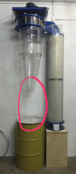

This creates the inlet to the dust collection bin, connecting to the outlet on the bottom of the cyclone with 6" flexible hose.

Finished the chip bin inlet. I sealed all of the edges of the foamed PVC flanges with silicone. It seems to have turned out well.
Fired it up for the first time. It is a lot louder than I had expected. This is a serious dust collector. I think I will have to build a small room enclosing it.
