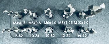

Ran parts over the weekend. While the machine was running I continued working on the pallet CAD work. A good fixture is not a simple thing. So many things to consider and so many ways to make them really useful. A few shots showing the carrier work holding I’m using. OP1 on the right. Held on the bottom 0.060” of the stock by the SerraJaws. OP2 on the left in soft jaws. Beginning of a cycle:
After:
This works well, but I’m wanting to double the number of parts per cycle.
The Pierson stuff arrived.
I’m using E-Z Lok’s coil thread inserts on the pallets. The pricing is really good. I’ve had great results with some of their other inserts in the past.
Carved out a few minutes to get a design done for ironworker tooling storage trays. I made a small test part to check fitment.
Worked out well.
The first tray complete and populated.
The text is 0.20” tall. I’m okay with the small anomalies in the text.
Next one is in progress. These take a while. It’s the max envelope of the X1C.

Quick note before I get into forming.. I really like these Milwaukee drill taps.
I use them for all sorts of fabrication related tapping. They are pretty robust and work well. Made a tray to make them easy to get the right size first try:
