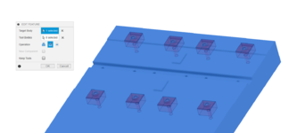

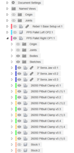

I've been contemplating ways to increase my part density and cycle time since I started making parts one operation at a time. I did a lot of reading and so on trying to sort out the right thing for my production parts. One of the challenges is the VMC only has 25.9" of X travel. Several parts are setup to use 11-12" stock, and one part is almost 12" long. I finally settled on the Pierson Workholding pro pallet system. They offer a 10x16" pallet. I can turn the long part and run it on the Y axis in this setup. Having 12" of material in the jaws of a vise is a recipe for lots of fun issues. The pallet will work great with that length on the Y.
In the end, I gain a lot switching the parts that I can to the pallets. Some parts will still be done in vises because it's the best/only way I have to make them. Those parts are long cycle times, so it's not as big of a concern. The longer cycle times mean I can work on other stuff while the parts are running.
I'll say this is a long time coming. I've been slowly working up to being able to handle the CAD and CAM for this as well. Definitely no easy feat compared to where I started. I did a rough model of the table at home tonight. I'll update the model with some measurements in the morning. This model will be included in all the CAM files. My favorite part is the WCS origin will not change! It's the center of the diamond point for X/Y and the top of the ground pad for Z. Everything will be built off that.
The table with the pallet bases.
The first pallet with the OP1 work holding in progress. There is stock on the right, and an open pocket on the left.
The whole getup with stock in both pockets.
The next step is bringing in the parts for OP2 on the bottom.

At first I didn't have any parameters. As things went along, I realized I wanted to be able to adjust the position of the pitbull clamps as I sorted out the design. This is when I started making user parameters.
This evolved in to me wanting the stock pockets to be built from user parameters. Specifically, the amount of crush depth into the SerraJaws. The parameters:
In that table you can see the equations I'm using for the stock spacing. Those parameters are used in the only sketch in the whole model:
It's the first thing I did in the model. This is how I kept the pitbull clamps parametric and easy to change.. There's a top and bottom clamp. Each has a joint using the parameters described above. The pallet side of that joint is the center of the line that is the stock edge. The PitbullX is the offset from that point. PitbullXspacing is the distance to the next pitbull to the right. I use one rectangular pattern to make the two far right instances:

THEN, the combine is used to cut the pitbull pockets into the pallet:
This is the power of doing it this way.. Let's say the stock is actually 2.02. I change that parameter and everything moves. Or I do a small test pallet and find out I want the pitbulls .02 higher or lower.. Or I want a similar pallet, but for a 4" x 5" part.

Edited to add: this is how the section view looks now. The "crush" depth of the SerraJaw is a parameter.
