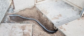

Looks like I used the same stucco contractor (in 2020) - FWIW he did good work on my 2000 sqft shop.
I had the same issue with control joints under the garage door seals. I'm sure you could stuff it with backer rod and use some sort of flexible self-leveling Sika product. Personally, I just mix up a little quick cure concrete and give myself a 1"-2" section there for the garage door seal to seal against. The experts may disagree, but in my opinion filling that small of a portion of the control joint isn't going to harm anything. Crummy example picture attached.
Another improvement in reducing the scorpions and spiders at my place has been to swap the garage hinges for green hinges (you can also just adjust your tracks, but I found the green hinges seem to maintain a tight seal better over time).

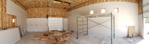

2nd day of drywall work. Full day for them today. They left the top 18" of walls uncovered to allow the inspection to complete (needs to see the wiring through the top plates). With the holiday on Monday, inspection wouldn't be until Tuesday at the earliest. Yes, they missed cutting the opening for one of the ceiling light junction boxes. Will be 6 fixtures. I know 2 of them are above the large door, but the large door will be closed most of the time, and I have those two on a separate switch for when the door is open.

Feels like a pretty good size right now. I'd say it's the biggest garage I've ever had to work in, but one of the other places we've lived was close - but rather unusual. It was 3 cars wide, but the single door on the left was double deep, so nominally 4 cars total. That house had so many major items needing work that I never got that garage really organized. Hopefully I can put more time into organizing this one.
