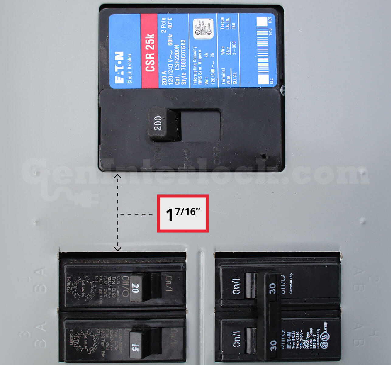

The generator interlock as mentioned is an easy way to safely utilize the house wiring with a generator while preventing dangerous back feed to the grid. You will have to install an appropriate backfeed breaker to match your generator. You will install an inlet plug on the exterior of your home to match the generator and the backfeed breaker.
Your existing electric main panel will determine the interlock kit you need and the type of breaker you will need to add.
You will need to study your generator's wiring schematic to remove the neutral/ground bond while you are powering the home. This is needed since there is supposed to only be one neutral/ground bond and that occurs at your main panel.
The interlock method gives you quite a bit of flexibility as you can enable and disable loads in the house based on the capacity of the generator. Conversely, if you are not careful, you can overload your generator if you leave all of the breakers on by mistake.

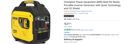

If you have NO 240V appliances that you need to keep running (well pump, stove, water heater, etc) then I think this an excellent choice !
Champion Power Equipment 4000-Watt Portable Inverter Generator
This unit is powerful enough, you could run a typical window A/C !
The best way to connect it to you house is a generator inlet and a generator interlock kit on your breaker panel. Do not use one of those generator transfer panels you commonly see ! (They only cover a limited number of circuits.)
If you are comfortable with simple electrical work (like adding a circuit to you breaker panel), then this is a DIY job.

@Rick_Br
Please take pictures of your existing main panel with cover on and off. This will determine the interlock kit you will need and the breaker type as well.
Then provide a load list of devices you would like to have powered by the generator. This list should be itemized by device such as kitchen fridge 120V 4.3A, sump pump 120V 6.5A, etc.
With information such as this, the group can guide you thru this.
I agree with @wyliesdiesels that if you were wiring new 120V and 240V circuits to your panel, this project is well within your grasp.
With a manual interlock, I think labeling the panel with the critical circuits is the way to go.

Pictures of existing panel attached
It seems the first decision is type of power source the generator uses. I would like to use N G but if I need to move it 20' away from the house then that gets complicated to get gas to it doesn't it? I have the perfect spot right on the other side of the block wall where the panel is located but that would be right next to the wall. With LPG or gasoline there is the problem of running out/refilling. any thoughts?

Here is the interlock kit for a CH panel, Plus they have everything you will need.……. Good company to deal with!
www.geninterlock.com
That is for BR series plug-on neutral panels ONLY. he has a CH panel (tan handle branch breakers) and it does not have the plug-on neutral bus. Notice the branch breakers pictured on that page you linked to dont have tan handle/ties?? They are BR breakers NOT CH breakers.
  • Fits 150 and 200 amp BR panels with PLUG ON NEUTRAL ONLY
wyliesdiesels
Aug 14, 2012
20,253
Modesto, CA
this should be the correct interlock for your CH panel though i cannot tell if the gap is 1.5". you will need to verify this. you can get a left or right side version.
