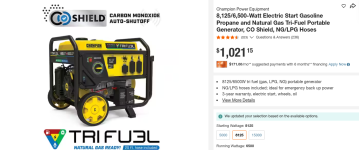

Honda, Predator (Harbor Freight), Champion.
Go with a tri-fuel ! LP and NG can be hard to start. (Not a fan of electric start. You can always give it a shot of carb cleaner to get it started.) There are some hand-carry portables, but depending how far you have to carry them ...
This model uses a lithium-ion battery so it should last a long time.
Quiet is always relative ! Enclosed are quieter than "open frame". Generator Noise Reduction Box DIY (Styrofoam)
All generators are capable of being connected to an interlock !
One other thing to consider. Inverter versus non-inverter. Inverter generators create a much "cleaner" output. I actually own 2 generators. A 30+ yo Craftsman 6250W (starting) non-inverter, open frame (very loud, drinks fuel) and a 4000w (starting) inverter, closed frame, hand carry. The only good thing about the Craftsman is it can run lights and refrigerators in 4 houses !
There are a LOT of open frame 240V generators, single and tri-fuel, available in the 5000W - 7000W range for well under $1000 ! They are big, heavy (wheels required) and loud. Bigger is not always better ! Typically louder and consume more fuel !
Also, if you want to run a whole house A/C or heat pump, you will probably need something over 8000W, even with a soft start kit installed.

Examples
"Using gasoline, the 224cc Champion engine produces 5000 starting watts and 4000 running watts and will run for 14-hours at 50% load when the 5 Gal. fuel tank is full. When using a 20 lbs propane tank, it produces 4500 starting watts and 3600 running watts and will run for 10.5 hours at 50% load. Using natural gas, the engine produces 4050 starting watts and 3240 running watts. "
  • Gasoline: 8125 starting watts and 6500 running watts
  • Propane: 7500 starting watts and 6000 running watts
  • Natural gas: 6875 starting watts and 5500 running watts

NG compatible is a deal breaker - both for inside storage and ease of operation. 120 volt only output is OK but I would like the 240 option. Somewhat light weight is probably needed - the one I linked above is 156 pounds - probably manageable. I would like low noise but the one above is 72dB - like a vacumm cleaner the internet says. I have been focused on Champion but maybe over the next few days I'll take a look at harbor freight and westinghouse.
So to summarize my requirements to date
mandatory - NG compatible, electric start, 120 output, somewhat light weight with wheels, minimum of 4000 watts running capacity wth NG
Nice to have - 120/240 volt output, higher watts - maybe 5000 with an inverter design with quiet running
Still looking to be under $1000 but can go higher for the right unit.
I've been fighting with myself all day to not over buy. I am forcing myself to remember that this is, relatively speaking, for short term survival. In the 10 hears we have lived in central NC there may have been one time where a generator would have been useful. As a result I can't justify a $10,000 generac investment.
So here is another question - with a generator it is working to create electricity whether you need it or not. Theoretically the generator would be running all the time, using NG, for potentially no good reason. I use a CPAP machine so I've been thinking about a way of powering that all night without running a huge generator - maybe a battery operated generator. Oh well - one more thing to consider.
As I was reading through your requirements, the Honda EU7000i exactly meets every point except price.
Have you thought about looking for a gently used Honda? The EU6500i is the previous version of the current Honda EU7000i. The only difference being the newer version uses electronic fuel injection giving it a slight boost in power rating. An older EU6500i might be found on the used market keeping you closer to budget.
I’d like to add another point: noise. A loud generator quickly becomes very annoying; you’ll hate it and so will your neighbors! That’s why I ditched an old, loud Coleman generator I inherited and replaced it with the Honda EU6500i. I’ve moved on from when I needed a portable generator but I still have the old Honda as a backup to my present system.
As to your last question, yes, the generator will run continuously once you’ve fired it up but at least with the inverter generators, they will spool up or down depending on load which saves fuel and reduces engine noise when operating under low demand.
To run a CPAP machine overnight, one of the battery based, so called sola-generators, seems like the best fit and silent too. Just make sure you size it correctly for anticipated needs.
Good luck whichever direction you go.
