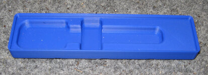

My general approach to starting something new is to begin with a simple test piece, iterate until I’m happy, and then move through progressively more complex designs until I get what I want.
So, instead of jumping directly into designing a tray for all nine ratchets, grab one ratchet and design a tray for it. One of the goals of prototyping is to minimize the amount of filament you waste, so start with the 3/8″ stubby ratchet instead of the 1/2″ long handle one.
First, how large a bin is needed to hold the ratchet? You can measure and check. Or just lay the ratchet down on a baseplate and eyeball it. In any case, the test ratchet is one bin unit wide and four bin units long.
Gridfinity base with stubby ratchet
In Fusion select the Gridfinity Bin generator. Tell it to create a 1×4 solid bin. We start with a solid bin and make a cutout to fit the ratchet. Hit Enter and the bin appears as a new component, ready to edit.
Next, create a Fusion Sketch on the top surface of the bin. Measure the ratchet and create an outline of the ratchet. The easiest way is to create two rectangles, one for the head of the ratchet and one for the handle. Center this outline in the bin.
Make this outline just a little bigger than the ratchet. How much bigger? Big enough to make it easy to remove and replace the ratchet, small enough for a good looking fit. A sixteenth of an inch is probably a good starting point.
Fillet the corners of the outline to make it look better and fit better. While not required this is easy to do in Fusion and makes the end result look more professional.
After finishing the outline extrude it to make a solid body and then extract this body from the bin to create the cutout for the ratchet. The depth of the cutout depends on the tool you are designing the bin to hold. For these ratchets 3/8″ is a good starting point.
Done!
Not quiet. The cutout is a tight fit on the ratchet and roughly half the depth of the ratchet. You can’t grab the ratchet – the only way to remove the ratchet is to pry it out with a screwdriver. Not the greatest user experience…
We need to add a finger relief to the bin so that we can easily grab the ratchet. The finger relief should be located where you naturally grab the ratchet. It should be tall enough to stick your finger and thumb into it – 3/4″ or 1″ is a good starting point. It needs to be deeper than the ratchet cutout so that you can get your fingers under the ratchet and pull it out. I first tried 1/2″ deep, but this cut through the bottom of the bin. 0.450″ was the deepest I could make it.
I couldn’t make the finger relief as wide as I wanted to, so make it as wide as the bin allowed. Extrude it 0.450″ and subtract from the bin.
Looks good, so send it to the printer. Wait patiently.
Pop the finished bin out of the printer, drop the ratchet in, and start checking how well it works. Some room for optimization of size and spacing, but overall a successful first prototype!
Prototype ratchet bin
Prototype bin with ratchet
It holds the ratchet but could be a bit longer. We can either tweak the model and make another prototype or note what changes are needed and include them in the final design.

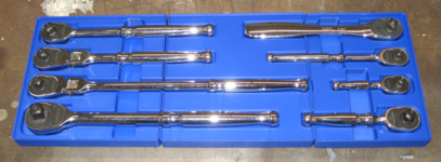

In the last post we made a Gridfinity bin for a single ratchet. The most flexible approach is to make a separate bin for each ratchet. This takes full advantage of Gridfinity flexibility – you can add more ratchets just by making new bins and re-arranging the bins on the Gridfinity baseplate.
The downside of making a bin per ratchet is packing efficiency – in many cases you can fit more tools into a given space by putting multiple tools in a single larger bin. Basically you arrange the tools in a way that minimizes space and then put a bin around them. In many cases this can reduce the required space by more than 25% by using this approach.
The choice is long term modularity and flexibility vs. fitting more tools into given drawer space in a tool chest. Of course it isn’t an either/or decision – in some cases one approach makes sense, in other cases the other is the best choice. And in some cases it makes sense to just pile the tools in a drawer!
I decided on a divide and conquer approach: spend time packaging my most used tools into efficient Gridfinity bins, lesser used tools into generic Gridfinity bins, and pile miscellaneous tools into a drawer.
As part of this approach I also decided to do selective upgrades of certain tools. For example, I have a random pile of screwdrivers that have accumulated over the last 50 years. These range from good screwdrivers – mostly 1970’s Craftsman – to junk that should really be thrown away. I’ll cover the screwdriver strategy in a future article.
I have, ummm, “several” ratchets. And breaker bars. And accessories like extensions and adapters. Some of them are junk. Over the last five years or so I’ve built up a collection of good Tekton ratchets that are my go-to for anything involving a socket. I have nine of these – eight regular ratchets plus a ratchet with a 24 inch handle for heavy jobs. Plus a three foot 3/4″ breaker bar for really heavy jobs, like the ball joints on a 1963 Imperial. I won’t try to put the six foot pipe, AKA cheater bar, that enhances the three foot breaker bar into the tool chest.
Studying the situation I decided to put the two foot ratchet and three foot long cheater bar across the back of the drawer and not bother putting them into a bin.
The remaining 8 ratchets were a mixture of 1/4″, 3/8″, and 1/2″ drive and included regular handle, long handle, stubby handle, and flex handle. All of these are useful and needed for dealing with various fastener situations.
Grab these ratchets and start trying different arrangements. The goal is to fit them into a minimal space while being able to easily pick up any ratchet.
After playing with various arrangements it looks like I can fit them into an 11 x 4 grid unit bin. My 3D printer is capable of printing a 5 x 5 bin, so I used the Fusion Gridfinity Generator to generate two 4 x 4 and one 4 x 3 solid bins.
I positioned these bins together in Fusion and then started creating the outlines for each ratchet. Once I had the outlines I arranged them in the bin with equal spacing between each ratchet. These outlines were extruded and subtracted from the solid bins to create the cutouts. After making the solid cutouts for each ratchet I studied the result for a while and then created a set of finger reliefs to make it easy to pick up the ratchets.
As a last step I filleted (rounded) all the edges. On heavily loaded parts this is critical for strength and to avoid cracks. Sharp inside corners are the most common place for cracks to start. It isn’t really critical for these bins, but it is easy to in Fusion, looks better, and keeps my mechanical engineering spider sense from tingling so strongly.
With the three bins designed, send them to the printer one by one. Total time for this was over 12 hours, but 3D printing is “fire and forget”.
Gridfinity Ratchet Bins
The three bins drop into the Gridfinity baseplate locking them into position. Add ratchets and done.
Ratchet bin with ratchets
The ratchets fit. Once the bins are dropped into the baseplate they don’t move. This fixes the previous problem with the ratchets moving around when the drawer is opened and closed. You can easily grab whichever ratchet you need. And you can tell at a glance if you have returned all ratchets to their proper location.
