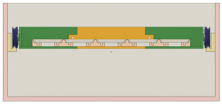

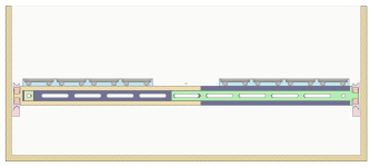

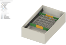

sansbury
Oct 7, 2023
105
Fyi to @zanyad and @Model A Fan and anyone else interested, I've done a couple new iterations on the design while I was stuck away from the shop. I haven't printed either one yet so caveat emptor but if you use Fusion and want the model file I'm happy to send it to you.
I ended up making two different versions. Both are driven by user parameters so they can be quickly adjusted to fit your exact drawer size. The first one is similar to what I posted above, and is mostly refined for easier assembly. It is adjustable so it will fit a variety of drawer widths without modification. If you have a larger drawer and want to put a good deal of weight on the tray then this is probably the better design as the support rails and cross braces (red/green/blue parts) provide a lot of rigidity. The placement of the baseplates is adjusted when assembled so the baseplates can sit against each other or wherever you want.
As I was finishing this I was thinking about some of the other drawers I might want to put one of these in, and I realized that this design eats a lot of vertical space as the section view below shows. 35mm or about 1-1/2" to be precise. I have some drawers that are more like 4-5" deep where tiered drawers would be nice if they didn't waste space, so I decided to try a second design.
This is the result. This one relies more on the baseplate(s) for the structure, so it is lighter duty but my gut says it will work fine for the kind of load you're most likely putting in something like this. If you used a solid baseplate like what's shown in the first design I bet it would take a couple pounds without complaint.
What this design gives up in structure it gets back in compactness, as you only lose about a half inch of space. This mockup shows how you could conceivably fit two sub-drawers with 4U bins in a drawer that's 5" deep.
This design is also fully parametrized but does not have adjustment built in, so needs to be printed for a specific drawer. I'll probably change that but want to make one or two of these first and see what I think.

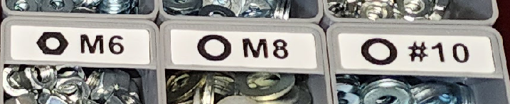

Are you able to raise the letters on your prints so they come out crisper? I'm slowly learning how to do this, and I think the way you can do it would be to (on Bambu's software at least) edit and add text to the top surface so it stands proud instead of recessed. You'd have only black on the top as the letters instead of a layer of black and then printing the negative in white to get the lettering.
I'm a big fan of the raised letters/numbers in how crisp and clean it looks, especially in small size.
The letters are raised. That pic was really zoomed in. Below is the full image. The lettering does get a bit ugly when I'm doing a longer label such as a "hexhead 1/4 - 1-1/2" but still very usable. This is all with a 0.4 nozzle and 0.2 layer height.
I am using gflabels to generate the labels as I am converting an old toolbox to hardware storage. Using the method you mentioned works good too.
Still a work in progress.

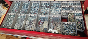

loganb
Dec 29, 2011
5,716
Omaha, NE
Metric hardware drawer...lot more containers need made, 5 more on the H2S right now. I'm stacking them, think they're setup at 6 or 7u tall and just clears the drawer above when opening or closing and stacked 2 high in this configuration
And the current configuration of the kids bathroom drawer
Obviously have a few more bins to make her as well to fill in the gaps and get rid of the boring gray for more aesthetically pleasing purple
