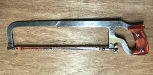

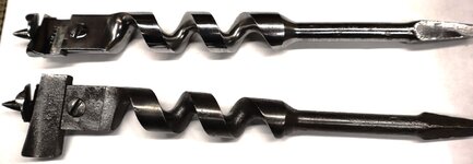

Anybody know this company? I just bought a hacksaw that is marked "S&I Co Pat Pend Springfield MA". I bought it because I also have two expansive bits marked "S&I Co". The expansive bits are identical to ones that James Swan made. Internet search came up with a "S.I. Never-Break" wrench but no other information. I've also searched DataMP.org, Alloy Artifacts, and the book American Wrench Makers 1830-1930. Nothing. The hacksaw has an interesting feature for adjusting the frame to different sizes using a simple pin/hole design.
Here are some pictures. Any help is appreciated.

Very interesting. Thanks. Wonder who S&I were?
30,016
^ The question remains unanswered until such time as some snippet out of a contemporary magazine or trade journal turns up more evidence.
It's a very slow process picking through them one page at a time looking for clues.

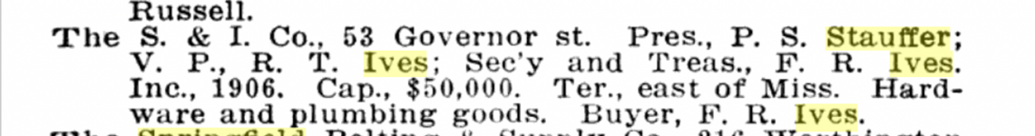

P. S. Stauffer and R. T. Ives
And I swear I’ve looked this up before, just don’t know where I posted it, and for who.
And yeah, we’re having a Rockin’ New Years Eve here, I just woke from a nap to continue this search, finding volume Pt. 4
