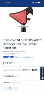

I have the craftsman version I bought years ago when Sears was pushing them. Used it once and it paid for it self when I damaged a thread on the mower engine while replacing the key.
