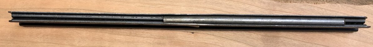

Pic 1 - the "tool" I used. 1/2"x11" piece of spring strapping with a slight bend at the tapered end. The tapper and the bend help it slide past the stops.
Pic 2 - A side view of the drawer and slide, showing the stop bar on the drawer.
Pic 3 - the tool over the stop, and under the slide detent.
Pic 4 - The inside of the box, the circles show the bent metal tabs that are used as stops.
Pic 5 - With the slide.
Pic 6 - The tool through the slide and over the stop.
You need to pass the tool all the way through the slide so that the detent on the slide rides over the tool and passes over the stops. It's important to keep the tool centered so that it doesn't slip off the stops while moving the slides.
Start by pulling the drawer all the way out. Position your tool in the slide and push the slide back into the box past the stop. Then do the other side of the drawer. Now you can remove the drawer and work on removing the slides from the box side.
As inferred, the detent is on the ends of the slide and the tab is on the wall of the box and on the side of the drawer the way this box was constructed. The tabs face towards the back of the box on the wall and towards the front on the drawers.
In the older boxes, the detent is on the wall of the box and back of the drawer, with the tabs on the slider facing the detents on both sides.
I'll discuss the method I used for the older box in the next post.

Jakemac had contacted me a while back about this thread as I originally had the question about trying to remove my drawers which is different than newer Huot's.
Jakemac was nice enough to start this thread, I have since found the correct tool to easily remove the drawer without any drama (easy peasy).
After the suggestion from another member (Packard V8) on GJ (Thank You), I went into one of my old standard size filing cabinets and stole one the metal holders that come with the paper folders for hanging files in the filing cabinet. It's the perfect size (5/16" wide x .029" thick x 12.75" L) for removing old Huot drawers.
I sanded the paint off the edge and thinned the metal down a little bit, I then curved the tip up by quite a bit. The trick is to have the drawer pulled out but to make sure the intermediate black slider is slid/recesseed closed all the way into the chest in order to have enough space/length from the front of the chest to the bent out black metal catch for the curved tool to have enough room to make it over the catch.
You'll know when you've cleared the catch when you hear the tool hit the back of the chest, once that is done with the tool still inserted slide the black intermediate slider out all the way out the front face of the drawer, that's when you know you cleared the drawer lock and black slider is forward then you can pull the tool out. Do each side prior to pulling the whole drawer out.

However, I wanted to pass on a tip I discovered by accident, and it works extremely well. Some of my drawer slides were bent and/or had wrinkles in the lips. Pretty hard to straighten out the bent and wrinkled lips. I was putting a large screwdriver in between the lips and banging on that, but it wasn't working. The metal is too thick to straighten easily, and the lips are too close together to get any tool, like a vise-grip based sheet metal seaming tool, in there.
Fortunately, I happened to have a piece of 1/4" steel rod laying on my bench, so I tried that, and it worked perfectly. All those stubborn bends and wrinkles disappeared easily. You just take a hammer and pop the rod down into the slot between the lips. It expands the lips enough to keep a tight grip on the rod, so it stays in there, but not so much that the lips don't spring back to their proper position.
With the rod in there, now you have solid all the way from your hammer, through the lip, rod, lip combo, and onto your anvil. A few light taps from the hammer on the dents, bends, and wrinkles, and they just disappear!
Here's a pic of what it looks like. If you had a longer piece of 1/4" rod, it would be even better. With one end of the rod overhanging the slide, just slap it on your bench, and the rod pops right out. With the rod not overhanging, I had to use a small screwdriver to pop the rod out to reposition it.
