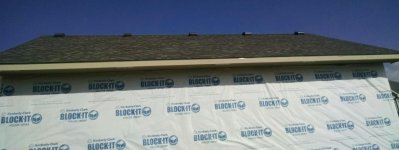

As you can see by a couple of photos in the previous post, I ran a little short on the house wrap. I decided not to buy a second roll as that stuff is pretty pricey and I was only going to use about a quarter of it. I thought I could snag a chunk from a place in town that sells donated excess building material. (part of Habitat For Humanity) They say they sometimes get the wrap stuff in, but don't have any at the moment. I did score a 9 x 12 piece, on Craigslist, and think it will finish out the front. I still need to cover the gable ends. I have an unused roll of synthetic underlayment that I was going to take back, but maybe I'll use it as wrap instead.
Now for the unfortunate circumstances of the last week. As I was returning from Menard's Monday evening, which was a trip to save some money on the fascia boards, a deer jumped from behind a tree strip, and I of course, hit her. I guess she didn't hear me coming. So my trip to save about a hundred bucks, cost me some doe. A thousand bucks, actually. Total damage to the car is in excess of $6000. Maybe I should go into body work. I was guessing about $3000, but the hood alone is $1300. I know it could be fixed cheaper, but it's not my place to negotiate for the insurance company, and it's going to cost me $1K regardless.

When doing siding on a ladder, you need two people.
Each one sets their ladder resting on the lowest course.
Easy to set the siding in place and nail.
But, with one gun is a little slower.
I notice the backside pic you have covered the upper edge of house wrap with siding and the gable isn't wrapped. It needs to overlap to prevent any water that gets in from getting on the osb.
It's not uncommon to trim the siding to soffit with cedar 1x2 or hardie 1x4.
Using trim will allow the cuts on your gable end to be easier.
They don't have to be exact.
Face nailing is definitely stronger, but really time consuming when prepping for paint!
Looks good!

Happy news! The siding is done. I was definitely correct in my assessment that the gables would be a *****. The weather didn't cooperate at all, last week. And while I didn't hear their excuse, meteorologists totally missed the forecast for the weekend. It was supposed to sunny and in the 60s, but instead, it was cold, dreary and damp. We forged ahead with a few extra layers of clothing. It was drizzling both mornings, so we waited for it to dry out a bit before starting at about noon. The sun came out about the time we finished, late Sunday afternoon, which provided a little extra daylight for me to to tear down the scaffolding after, our one hour earlier, sunset. (End of Daylight Savings Time, for those of you not reading this in real time.) The framer was kind enough to put off finishing a couple odds and ends, so that I could use his scaffold to do the job. He came today, finished his part and left with all of his stuff. I, in turn, went out and swept up about 50 pounds sawdust, dirt, and wood debris, so I can turn my focus to the inside. I will be temporarily installing some of my lights and powering them with an extension cord. I hope to get all the wires run in the next couple weeks, so that I can get framing inspection done and start insulating.
In response to highflier's comment about house wrap. I bought roofing underlayment that comes in 4 foot widths and installed that in the gable area. I was able to stuff it behind the top row of siding, which was where the top of wrap was. I had about a 6 inch overlap.
