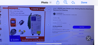

Apr 27, 2016
5,230
1500W, water cooled, dual wobble gun. Generator is racus brand sp? Seems pretty well put together.
PCustoms
Jul 23, 2011
23,450
VT
Do you have 2 profiles here?
Which one did you buy ? it has an S an A chiller with a Raycus laser
did it work out of the box ? Yes once you figure it out
And how do you think it would work compared to a TIG welder doing automotive sheet metal fabrication ? it is faster and same low heat!
