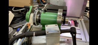

IMG_1308.jpegIMG_1307.pngThis was the rig with the tig. Don’t need all the extra gas coverage with the laser. Don’t have any pics of the current setup, but can get some.

Not sure why the photos posted twice. That was before I got the 1 1/8 gas lenses. The tig was too hot and very inconsistent at lower powers.

Kind of difficult to get really good photos. Things are only 3/16!dia. But I can tell you they are way better than the tig welding we were doing. That was also pretty good.

Sorry a little late now but fusion orbital welding of small diameter (1/4") tubing is very common for high purity gas connections in the semiconductor industry. It's a tiny little TIG head that spins inside a split "jaw". The most common vendor in the field was Arc Machines, but Swagelock makes systems as well.

Thanks for the response. Orbital welders are crazy expensive! Last revision of this machine was running a tig with 0.020” tungsten. Still would make the haz too hot. We are putting some very nasty **** in these capsules and really trying to keep the dirty bomb option off the table. With the laser you can touch the weld immediately after it’s done and it’s bearly warm.
