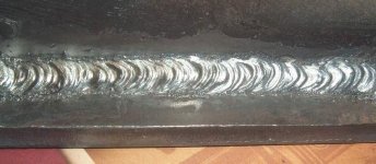

I've always wanted to learn, and have this ability.
Picked up some welders. Lincoln AC/DC tombstone, Lincoln 3200ES MIG and Lincoln Invertec V275S stick/TIG (Steel).
Just started school to learn at my old age (68).
Doing a number of stick assignments beginning with running beads, then lap joints and then whip and pause.
The first two with 6013 took me a while to finally get somewhat consistent results. See photo below of the last lap joint. Took a whole 4 hour class to get to get to that one, which still gets shaky at the end.
But the whip and pause with 6010 is discombobulating me because of the difficulty I have with getting a consistent width and controlling the heat. It gets too hot and penetrates completely. And the finish that results is odd to me.
The next one is creating a T shaped assembly by running a root and 2 overlapping stringers on each side. Everyone is having difficulty with this one.
I can see it being impossible as it requires 6010 and the whip and pause, both of which I am uncomfortable with. See assignment photo.
Any hints?

Watch the puddle, the arc and rod is in your peripheral vision. With practice control will become easier. As you whip away you need to increase arc length too so as not to deposit in the area you whip over. ...practice,practice,practice,practice,.....

I've got the HF Vulcan auto helmet. On my last lap joint, I was finally able to get a wide and comfortable stance with my feet, a brace position that allowed controlled movement and a good look at the work. I used some soapstone to mark the edge of the lap and concentrated on smooth regular movements. My problems had been going to fast and keeping the electrode too far away. This time I changed both of those. Funny thing is someone was calling into my booth, telling me to come out, as the instructor was doing a demo. I just pressed on and finished. Came out OK.
On the last whip and pause I only looked at the puddle and moved the electrode to move the puddle. Felt like I was right down in it. Felt good but need more practice to feel comfortable that I can be consistent.
Still fun, but hard on an old body that is way out of shape. Maybe next week I will grab an extra session to get more practice in.

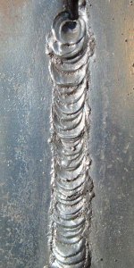

Those welds look pretty good for starters Bill. Now these are from a class, not intended to be perfect but to demonstrate whip and pause. 4 is open **** overhead, no bevel 1/4 plate, full pen. 1 is showing how much dig can be done and stacking it back in. Melting right thru a T joint.
2 is another open **** vertical and in 3 one can see the difference in whip space.
5 is a crack repair with a more refined whip.

3 was sposed to be whip speed and spacing. Can change that for the amount of dig and penetration, useful for sheet metal.
Ok, here with 6010, an old box I found, speed was everything, I really don't roll the pipe but weld most out in position. Crude fast fit, single pass no leak. It's getting buried and after some weathering the welding looks way better. Square cut open ****.

It's all,, or should say a lot about arc length. After a while it can become instinctive. While the finish is a little ruff on 10 I can go on forever without leaks.

Stayed late after yesterdays class to get more practice.
After numerous attempts that got worse and worse, I finally got a better root pass with 6010.
I know, lots of spatter and undercutting and voids.......
Bill

sberry
Jun 18, 2005
35,747
Brethren, Michigan
Whip and pause is in a straight line. Moving side to side and not pausing long enough and tightening the arc is what causes undercut Ald splatter.
I should have cleaned this first pic, the finish is quite good.
Second is overhead, these are magnified a lot and were not to be perfect but examples. The thing to note is each ripple is a deliberate stroke.
Pic 3 is where the learning curve was going up between the right and the left. These are in the position they were welded in.

bdbecker
Nov 18, 2015
5,585
Iowa
...I know, lots of spatter and undercutting and voids.
Still looks better than a lot of the welds I did when I was first learning!
There will be a day when all the sudden it just clicks. Its the strangest thing, and its really hard to describe, but you'll be watching the puddle one day and all the sudden you'll realize that you've got it figured out. I actually kept the test plates from the day I put down my first "good" stick weld - ran across it a few months ago and put it on my desk in my home office. I've done better welds since then, but man, I was so proud of that weld on that day.
