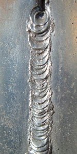

Spent a 12 hours in the welding lab today.
Got into doing horizontal and vertical up welds. Used some 7024 which produces very nice welds. Easy to work with.
Finally figured out whip and pause in a 3/32 channel vertical up. Need to retry on the flat and horizontal.
Got some help on the vertical up lap which helped.
So far the classes have turned a few grand of steel into a few hundred worth of scrap.
Bill
A couple of beads:

Those look pretty good. You are getting a grip on whip and pause. It's ok to take a spin on other rods but,,, once you get the 6010 and the lo/hy the rest follow and those are the basics and where the rubber hits the road and unmistakable between someone knows and those that think they do.
You got some talent, guys should take the time to learn this way earlier in career.
I mention exagerated motions and when I am trainging welders tend to get to vertical as fast as I can, again, a guy can do that most the rest follows. This is a gap fill, square ****, no bevel full pen. Each little ripple is a deliberate stroke.
