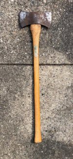

Just dug this vintage Craftsman Double Bit Axe (9" x 4-1/2" head x 36" long handle) out of the corner of my garage this past weekend. offers welcome, if you have any good ideas how to best ship the thing.

31,057
Anybody got a guess of how old it is?
American Fork & Hoe was using that logo in the 40's. It's the identical logo that wartime collectors look for on a Dayton pattern No. 4 axe for the pioneer kit that was attached to the side of a Jeep. True Temper was not a company during WWII, it was a brand, trademarked in 1929. It became the name of a company in 1949, when American Fork & Hoe changed their name to True Temper. It became a brand again in 1999, when True Temper was bought by Ames, becoming Ames True Temper, and later, The Ames Companies, then just Ames. American Fork & Hoe bought Kelly Axe Mfg Co in 1930. They used the name Kelly Works for a few years, but eventually began incorporating it with the True Temper brand. "True Temper Flint Edge Kelly Works" axes were supplied by the American Fork & Hoe Company, not True Temper (again, not a company), not Ames True Temper (which did not yet exist), and not Kelly Works, which no longer existed.

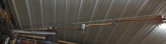

Well, I'm Beez... and I'm an axaholic. A few shots from around my wood shop. It is a steel building with 3/4 inch rod diagonal supports so hung a few up there.
