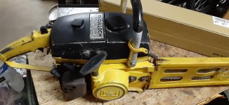

I bought a McCulloch Super 2-10 automatic a little while ago thinking it would be a great resto project. It was for a very silly reason; I really like the right side start saws, being an older made in USA saw meant I there would be no metric fasteners on it so I would only need one set of allen keys and sockets. The guy wanted $35 and said it ran. The problem is it needs no restoration, it all works perfectly and looks to be in great shape too. I've run it only a few times as I typically have 40:1 in everything and knowing this is supposed to be somewhere between 16:1 and 32:1, I just poured more oil right into the gas after filling it a little with my normal mix. It runs fantastic and my only reservation in using it is that it has no brake. I'll have a picture posted in a bit after I clean all the dust off.

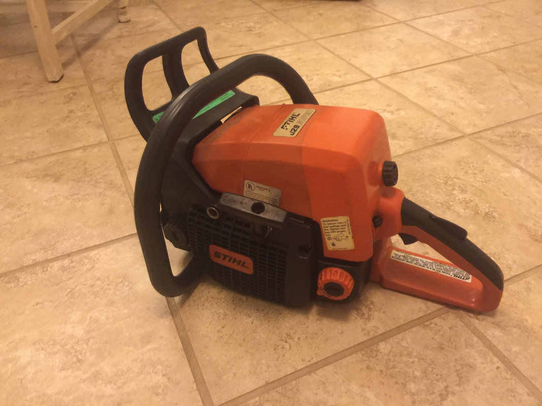

Picked this 034 saw up yesterday for $50. The guy said it needed a new coil. He threw in a new bar and freshly sharpened chain.
View media item 100280
First thing I did was pull the plug. This is what I found.
View media item 100281
I replaced the plug and the saw started right up and ran great. I looked in the plug hole, and the cylinder and piston looked perfect. Also pulled the muffler today and not a sign of scoring. And this saw has a ton of compression.
Your Mac (along with all -10 series saws) are supposed to run at 40:1.
The older saws such as the 5-49 & 7-55 (16:1) and the PM800/805/DE80 and SP80/81/105/125 (32:1) ran a richer mixture. That being said all my PM800 & DE80 and SP-125 all run at 40:1 as oil technology has improved over the past 50 years......

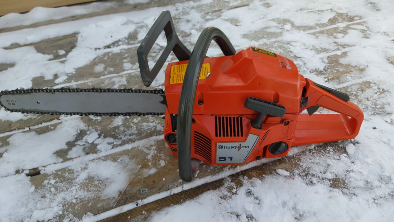

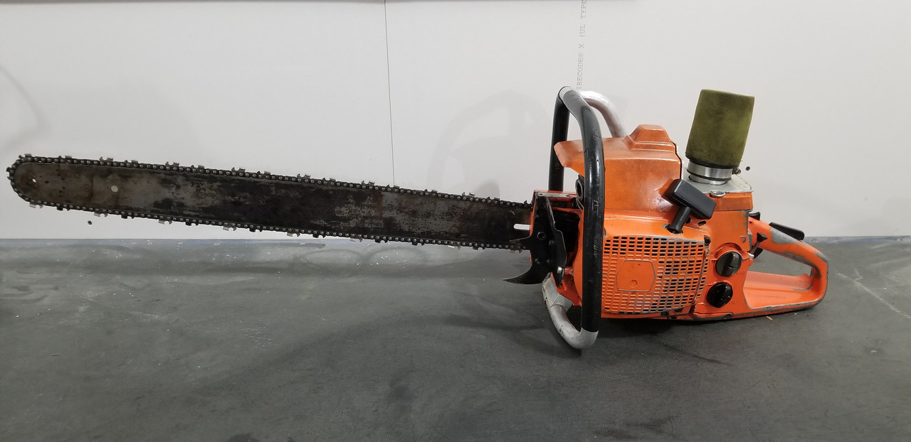

Sthil 039 - Ported
Husky 51/55 Conversion - Ported

Cool old saw. According to Acres, it looks like the manufacturer recommends 20:1. New 2 stroke oils may not require such a high ratio though.
Here is a little info on it for you.
http://acresinternet.com/cscc.nsf/ed1d619968136da688256af40002b8f7/e35f4988a0df72d488256b6100194537?OpenDocument
Unfortunately, Arces site isn't the gospel people make it out to be. The Mac -10 series are, and have always been 40:1.

I've relied too heavily on acres but it is a good assembly of information. Thanks for the snap shot of the manual, I mix my 2 stroke gas a little on the rich side usually between 38:1 and 36:1 and I'm using good oil so I'm confident I'll be safe.
