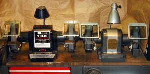

let's see your craftsman block grinders
rcjoy
Dec 12, 2010
146
Los Angeles
Here's a couple of mine ...
