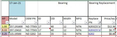

Do these 1/2 hp take the 6203 bearings like the 1/3 hp do? I haven’t disassembled yet

Just picked up this 1/2 hp 397.19590
The bearings are determined by the arbor dia. and bearing width. See the chart below.
NOTE: My incomplete list does not show it, but most 1/3 & 1/2-HP Blocks use a 1/2" arbor. Model 397.19410 below, is unique - it has an electronic brake.
NTN Bearing
6202Z
Single Shielded
15 mm Bore ID 0.5906 in (1/2 in shaft 0.500 in)
35 mm OD 1.3780 in
11 mm Width 0.4331 in
NTN Bearing
6202ZZ
Double Shielded
35 mm OD 1.3780 in
NTN Bearing
6203ZZC3
Double Shielded
17 mm Bore ID 0.6693 in (5/8 in shaft 0.625 in)
40 mm OD 1.5748 in
12 mm Width 0.4724 in
NTN Bearing
6203Z
Single Shielded
40 mm OD 1.5748 in
