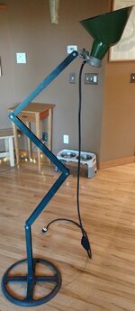

I found this old girl at a FM last week and couldn't resist. It an Ajust-O-Lier with cast iron frame and this thing can extend out to almost 3' or so and can adjust to just about any position. Machinist, medical or draftsman lamp??? I can't find much about Ajust-O-Lier.P1110492.jpgP1110493.jpgP1110494.jpg
