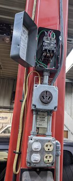

Not really “mods” as I am still in “setup / adjustment” phase of my lift install, but some things I’ve done.
Made a bracket for an emergency stop switch (idea from this thread) and mounted it to the power unit plate.
Found a 2’ 12/3 whip with triple outlets on the end at Rual King. Got two of them and cut the opposite end off each one. Used them to wire into the emergency stop switch.
The line side runs up to a 40’ 12/3 extension cord that runs up across the joists and down the wall to an outlet. The load side has the triple outlet end and dumps just under the stop button.
The lift is plugged into the triple outlet and the remaining two will be used for led tape lights when I get to that point.
I stuffed the excess lift power cord up into the arm that holds the power unit.
Nearly anything that comes with push clips gets them replaced with the quick ring type, did just that to the pin on each lift caster.

Number 9, I've seen other posts regarding an emergency stop but I guess I just figured maybe something different on those lifts, but you've got the same brand as I. I guess I'm not sure I totally understand the point.
Now I do have a lockout switch so lift can't be turned on, but it's there a problem with the motors on these sticking and running? If that happened it would be on way up and they aren't exactly fast. Going down there's the release valve and the safety lock that both need to be held. Power isn't used to go down so only useful going up.
Can you clarify why you think important? Looks like a clean install regardless!!

I’d seen other posts of adding one, read accounts of button sticking or failing internally (not on an Advantage lift) and thought it would be cheap insurance. My teen boys will use the lift too, so should something like that happen and I’m not right there at the time, it’s a panic button for them.
Fix Until Broke
Feb 21, 2016
796
SE Wisconsin
Some hoists use the pushbutton to start the motor to handle the full motor current. This is a huge inductive load to make and break with a small microswitch. The scenario where an e-stop is handy is when you're setting the hoist arms. You swing them under the vehicle on one side (typically the motor side :)) and bump the hoist up an inch or two for accurate placement and the motor doesn't turn off. You can stand there and hold the lowering lever to keep the hoist from raising one side of the car up - remember the other side hasn't been set yet - but you might be there a long time waiting for someone else to turn the breaker off.
In a perfect world this would never happen because you'd always set the opposite side first, the vehicle would always be perfectly centered in both directions on the hoist, there is never anything on the floor that interferes with the hoist arms, there's always a 2nd person in the shop, etc. Now, back to the real world...you install a secondary means of stopping the hoist.
I understand for some lifts it might be good. For the 4 post advantage, I didn't see a need, but I get it with the teens using it..... maybe i overestimate the pushbutton that's on these as well.

Here's some pictures of the pushbutton - Doesn't last long making/breaking current on a highly inductive load...The switch now just operates the coil on the motor starter above it. Still inductive, but a couple orders of magnitude smaller.
One switch in parallel with the push button so you can lift the hoist and walk away, 2nd switch is the "oh poop" switch that cuts power to the motor directly.
We added a couple outlets as well for power tools, welders, etc

I was looking at getting that Paddle Switch. What device box did you install it into? I've been reading about people having issues finding one that can fit the depth of the switch.
