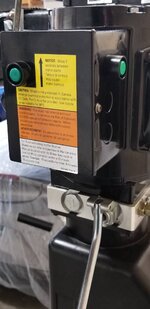

flyt100
Dec 1, 2015
109
Minnesota
I added a second button in series for safety. Now both buttons need to be pressed to operate. I had a button stick once, and this will prevent that exciting experience from happening again...

WaterBoyz
Nov 16, 2015
368
Northern VA
I've heard of that.
Seen some people install a panic shut off button. And some of those use that button to keep their grandkids or tourist from operating the lift.
WaterBoyz
Nov 16, 2015
368
Northern VA
I've heard of that.
Where did you get the matching buttons?

flyt100
Dec 1, 2015
109
Minnesota
I've heard of that.
When the button got stuck originally, DirectLift sent out a new switch/button. I examined the old one and found how it got hung up and by bending some of the metal/adding a washer for a spacer, etc. I got it to where I didn't think it would hang up again. I re-used it as the 2nd button. I just drilled a hole in a knockout to fit it, and I can reach both no problem with one hand.
