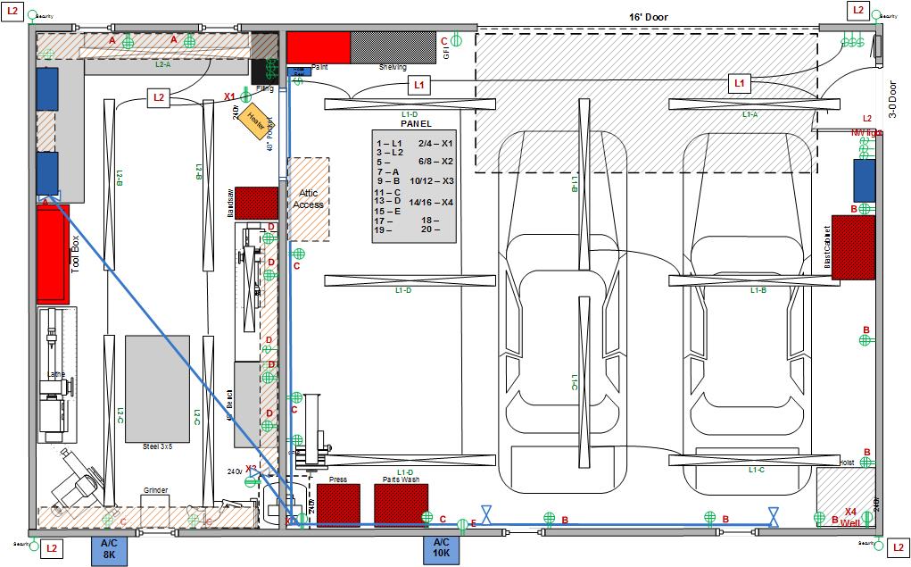

Thanks for the info provided thus far Platonic. Would it be worth checking out my garage? It's a small space with some fixed shelving that makes the space feel even smaller. I'd like to optimize light around the vehicle space and provide plenty of light to the work area on the left. Is the attached graphic I made enough information? I do have task lighting installed under the cabinets over the workbench.
I already bought a bunch of Lithonia 205CKL 4' x 4 bulb fixtures but have not yet installed them.
Thanks,
Steve

baneonrt, I have several layouts in cue. I would do something along the lines of the layouts in posts: #10, 11, 14, 15, 33 & 34, using either F32T8 bare 2 lamp strip lights or 2 lamp wrap version of the fixtures you purchased. How many 4 lamp wraps did you buy?
baneonrt
Dec 2, 2008
76
Sacramento, CA
I purchased 8 quite some time ago. I saw this thread and thought the purpose was to provide custom lighting distribution based on specific garage layouts. I figured the cabinets on the walls of my garage would have a bigger impact so posted my setup. You're not charging for this service so if you think one of the previously posted layouts is fine then that's fine with me.
Plus it was an excuse to play with sketchup some more :)
Steve

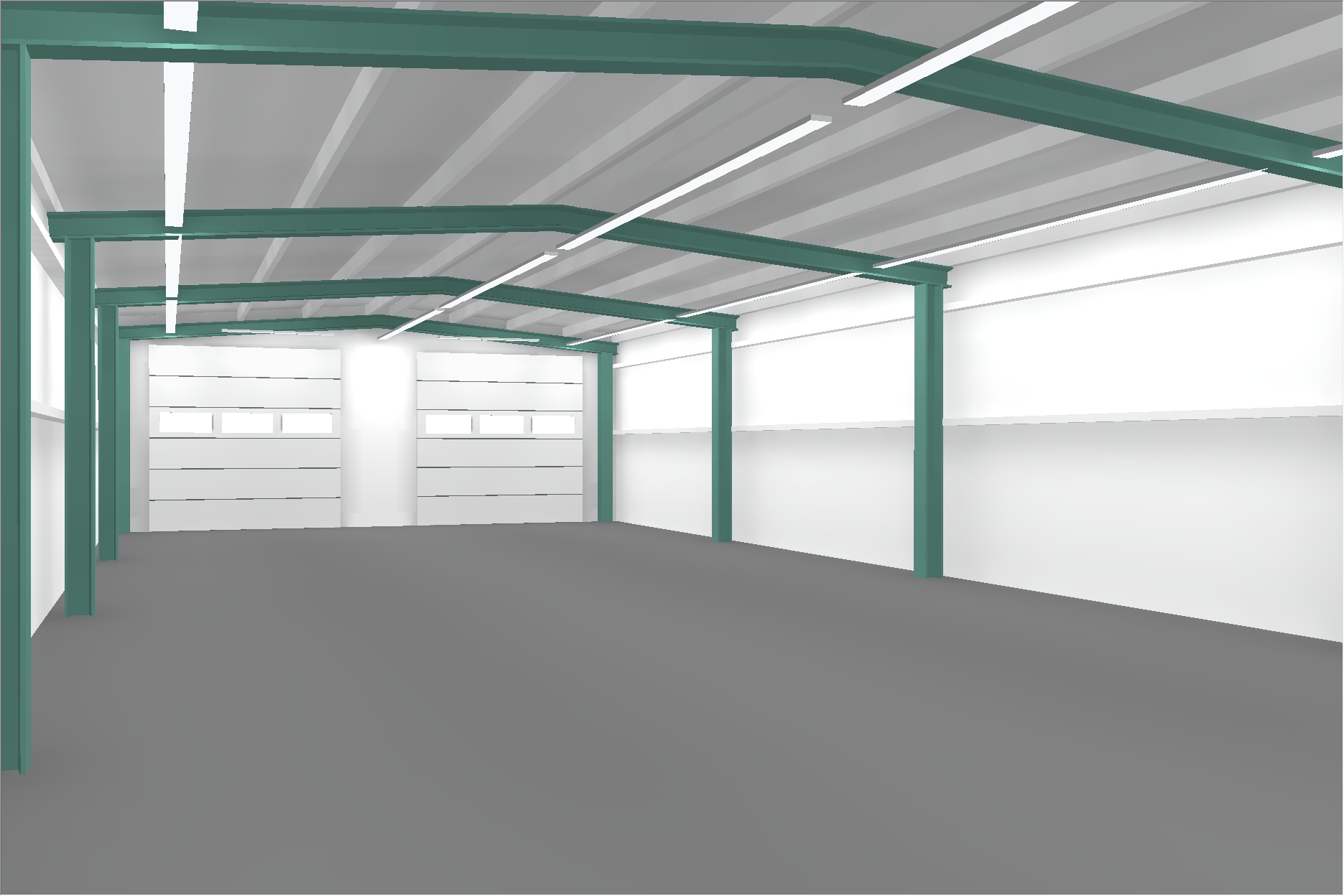

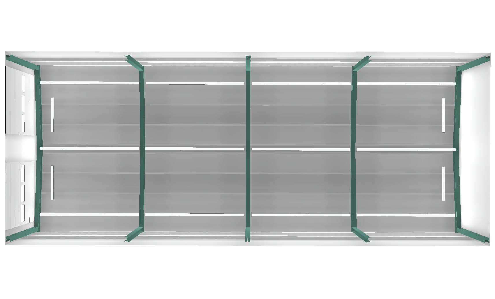

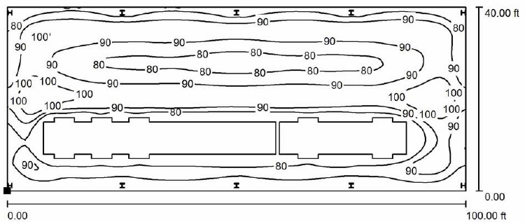

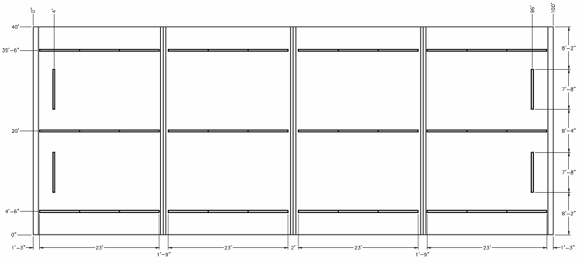

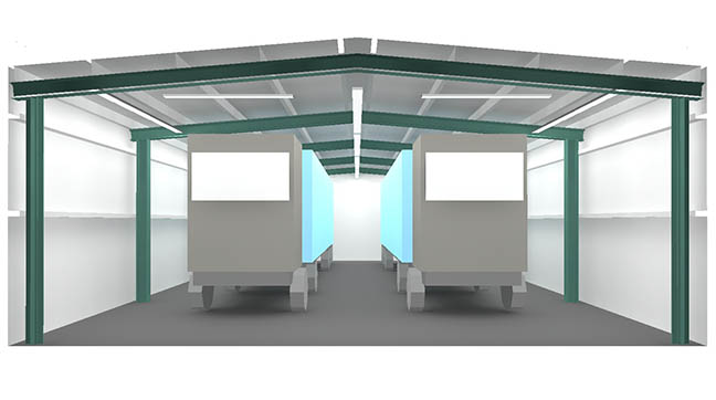

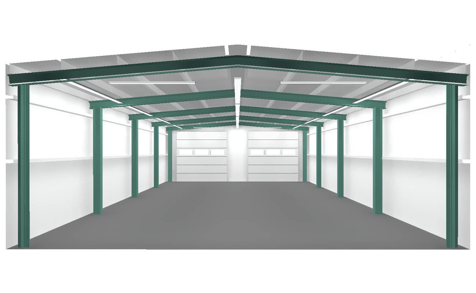

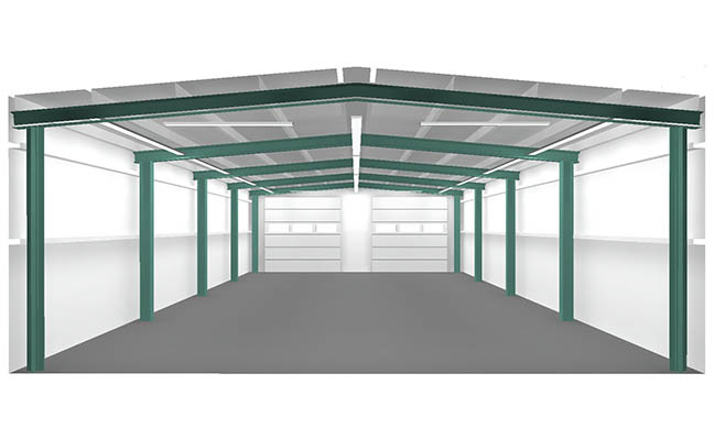

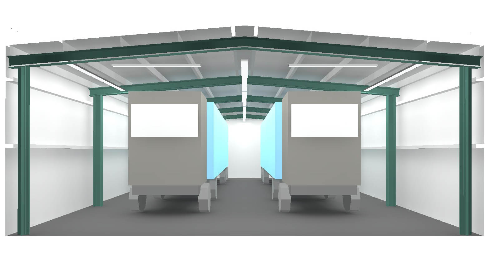

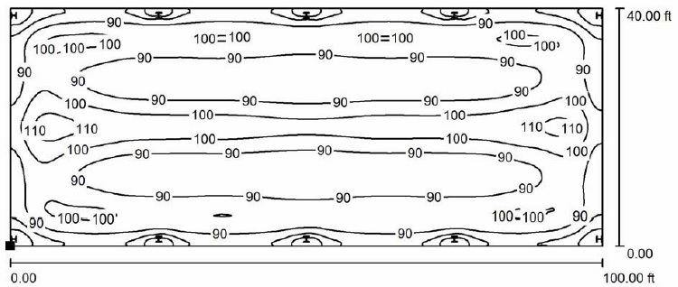

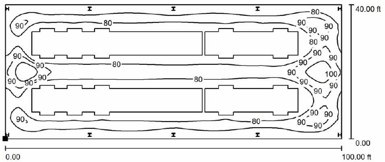

40 x 100 x 16 for Big-Rig Trucks
Original Request by: thejudges69
New Construction (pending) 40x100 steel pole barn, 16' side walls, 1-12 roof pitch, 17'8" center.
Use: Truck maintenance.
Truck Size: 80' long, 9' wide 13'6" tall and 9' wide
Provided complete drawing package.
Recommended layout:
Fixture = Qty. 40, US Energy Sciences FSL-045408-EA (linked) Strip 4 Lamp T5 8' Fixture with MIRO low profile reflector (you must get the MIRO reflector for this layout to work) available at shineretrofits.com for $92.50 ea., thus total = $3,700
Bulb = Qty. 160 (exactly 4 cases of 40 lamps), Sylvania 20949 F54T5HO 5000K $4.68 ea.
Reference linked spec sheet for accurate estimated lamp life = 40-45,000 hrs.
Total Bulb Cost = $750
Grand Total Fixtures and Bulbs = $4,450
This layout takes the ceiling light and pushes it down to maintain light levels at workplane when big-rig trucks are in bays.
Fixture Mounting Height = 15' minimum
Foot candles @ 30" workplane
Empty
1 Truck
2 Trucks

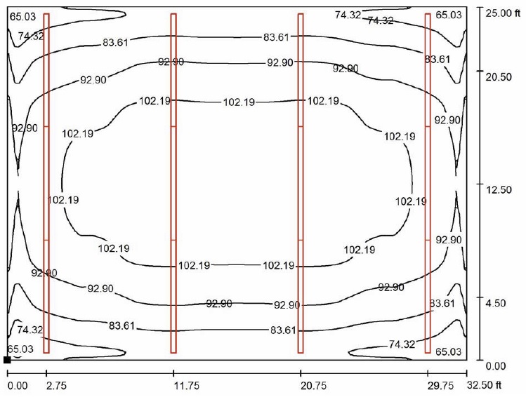

PhantomEB 24x24x10:
12 recessed 4-lamp troffers = 147 Fc at workplane
12 recessed 3-lamp troffers = 112 Fc at workplane
12 recessed 2-lamp troffers = 76 Fc at workplane
