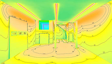

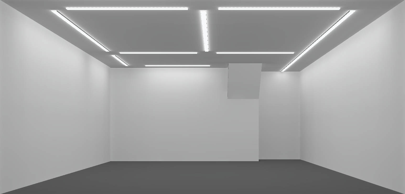

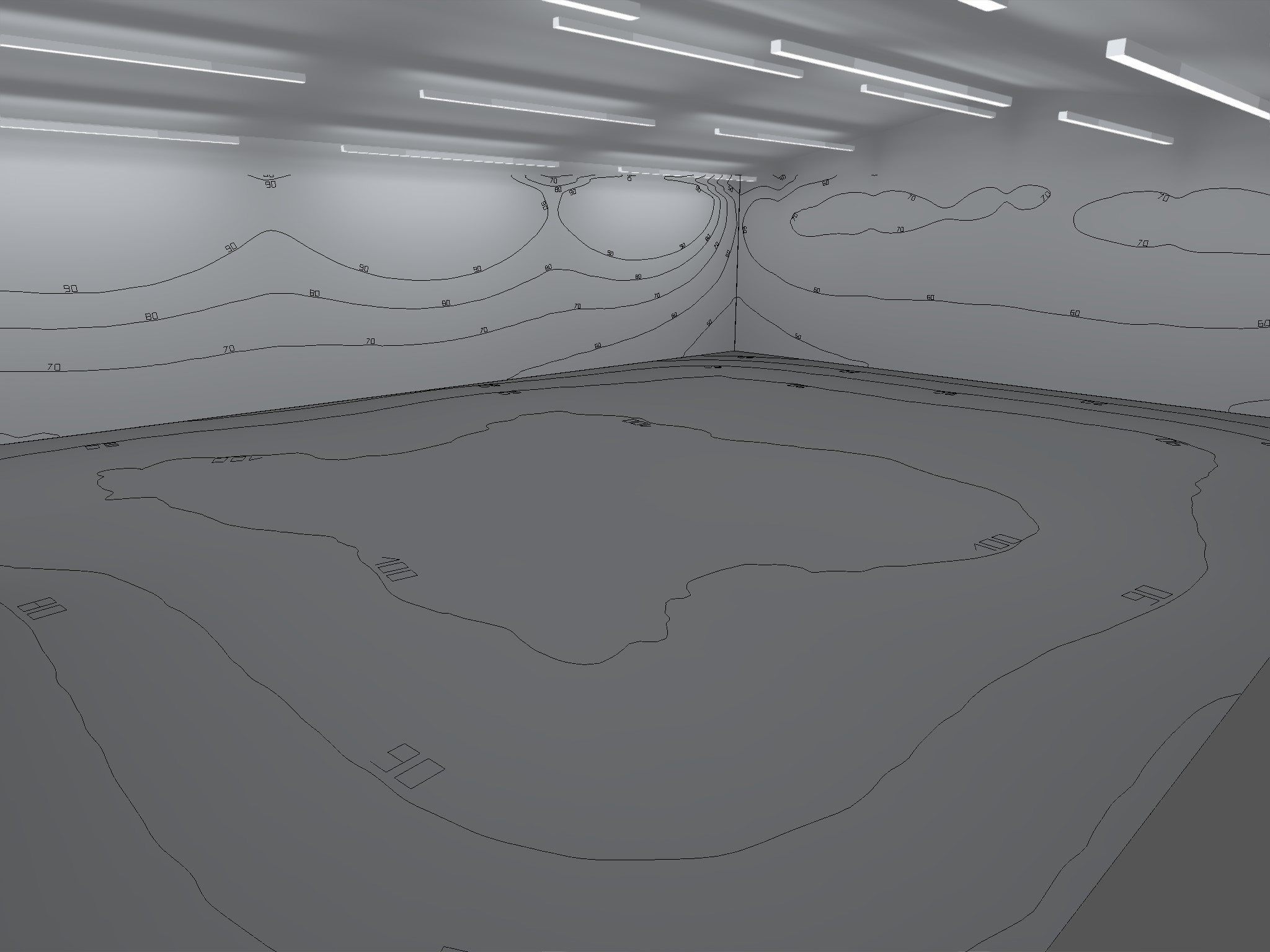

Since I’ve spent a fair amount of time doing Light Fixture Layouts for GJ members, I figured I'd put them all in one thread as a general reference guide. I’ll start with the latest and add more as time permits.
All Isoplots in footcandles and done at 30" workplane height (30" from the floor).

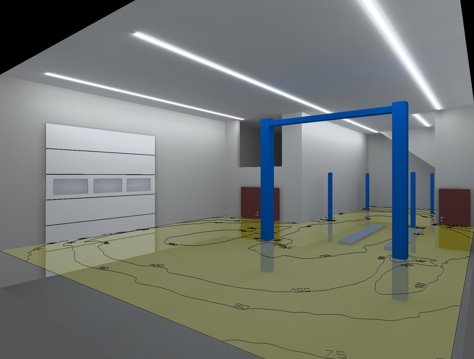

Shivatron, please define intended use. If I assume 2 midsize cars, there's not much space left for anything else. Put a workbench in there and that bay will only be usable for a compact car.
Shivatron
May 22, 2015
7
Austin, TX
Correct, two cars is the intended use. There will never be much of a workbench there, though one car is very compact (Miata) so I do have a bit of room in the right bay (when viewed from the garage door).
TTA89
Feb 23, 2014
230
New Hampshire
Sure, please provide exterior workshop wall dimensions, garage door width and type. Lift location dimensions would be useful too.
I finally got back up there. Thanks so much!
Added more dimensions to the drawing from page 1, garage doors are roll up.
The ceiling will be 15 feet to the sheetrock and I'd like to use T5HO if possible to reduce the amount I need.

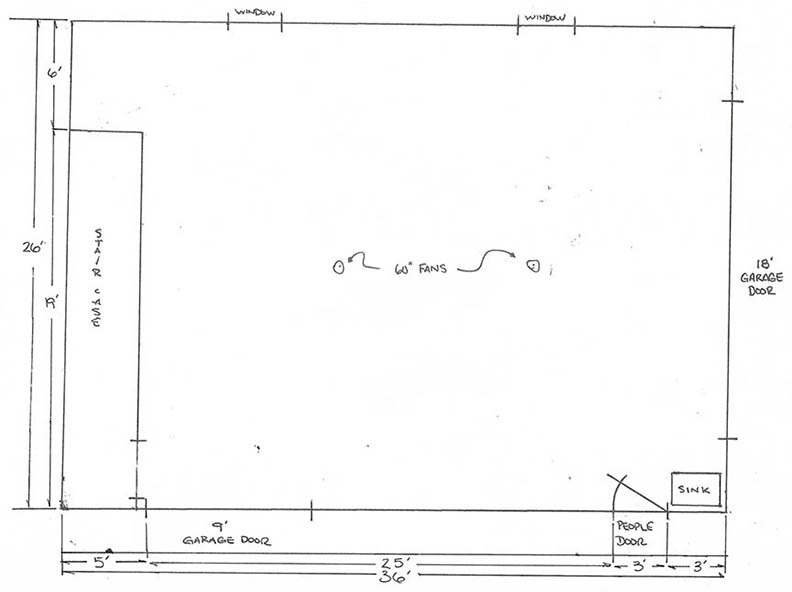

youwish2bme 26x32x12
Suggested Fixture: Cooper Metalux 8TSSF-232-UNV-EB81 (or equivalent) available at ronshomeandhardware.com for $42.99 each.
Qty.: 14
Suggested Lamps: Sylvania 22026 Fluorescent T8 Fo32/850/Xp/Eco3 available at globalindustrial.com for $2.93 each.
Qty.: 56 Lamps
CAD Drawing rotated as I didn't have exact width of stairs.
6" deducted per exterior wall for interior dimensions.​

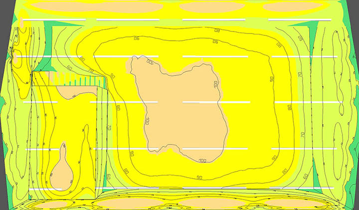

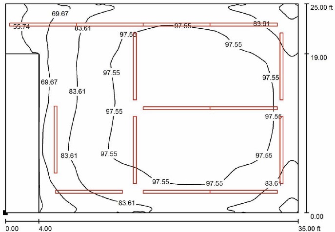

gt1guy 50' x 80' x 18' (16' Walls)
Request via PM from gt1guy
Shop is a gable clear span with white insulation on walls and roof. Concrete floor left as is. The 12x12 and both 20x14 doors are sectional overhead that hug the 2:12 roof pitch. Lights can be mounted under where an open door would be. Shop use is machine work/Sheet metal/hotrod fabrication/welding and I hate shadows. Above the office and storage rooms is used for more storage. No sky lights or windows in shop area.
P
Platonic Solid
Nov 29, 2014
3,587
CT-USA

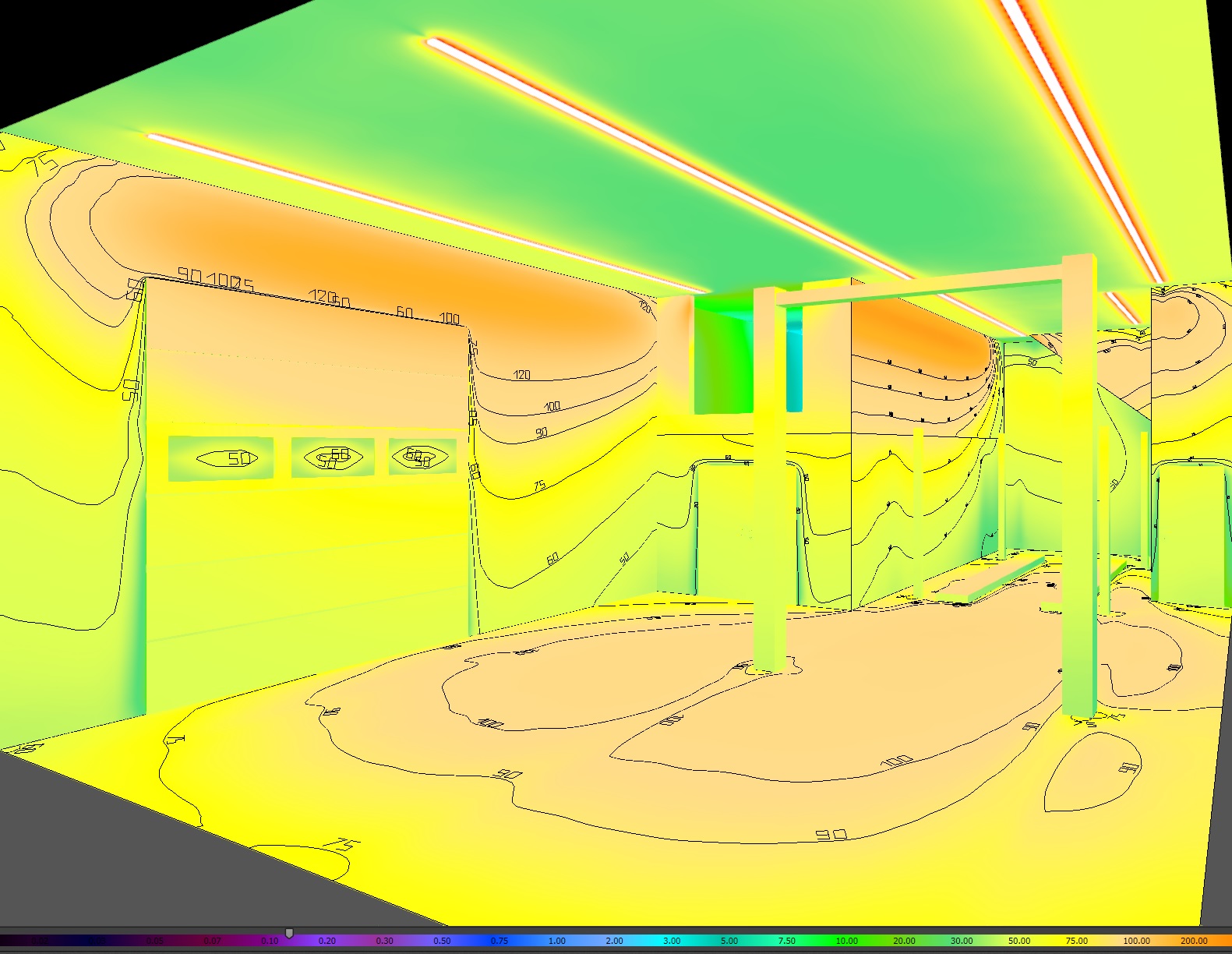

Suggested Fixtures and Lamps:
Qty. 37 Lithonia TZR 2 54T5HO MVOLT 1/4 GEB10PS
or Cooper Metalux 8TSSF-254-UNV-EBT1 or 8TSNF-254-UNV-EBT1.
HD's $70 price tag for the Lithonia is hard to beat. Might want to open one and see what brand ballast is in there before buying 37 of them. I see HD sells what appears to be the exact same fixture without the "R" designation (I assume that means residential), thus TZ 2 54T5HO MVOLT 1/4 GEB10PS for $100.
Qty. 148 Sylvania 20949 F54T5HO 5000K $4.68 ea.
The 30,000 hr. life on the site is wrong. The most current Sylvania spec sheet (linked) says 40-45,000 hrs.
I linked to this bulb on a prior layout at $3.80 ea. from 1000bulbs dot com, but that may have been an error on their part as they now don't carry it at all.
(Click all images for larger views)
fc plots at 30" workplane height. Average illuminance = 94fc
gt1guy provided a complete build drawing package which made it easy to get carried away with detail.
fc = 90-100 on all workbenches and surface plate.

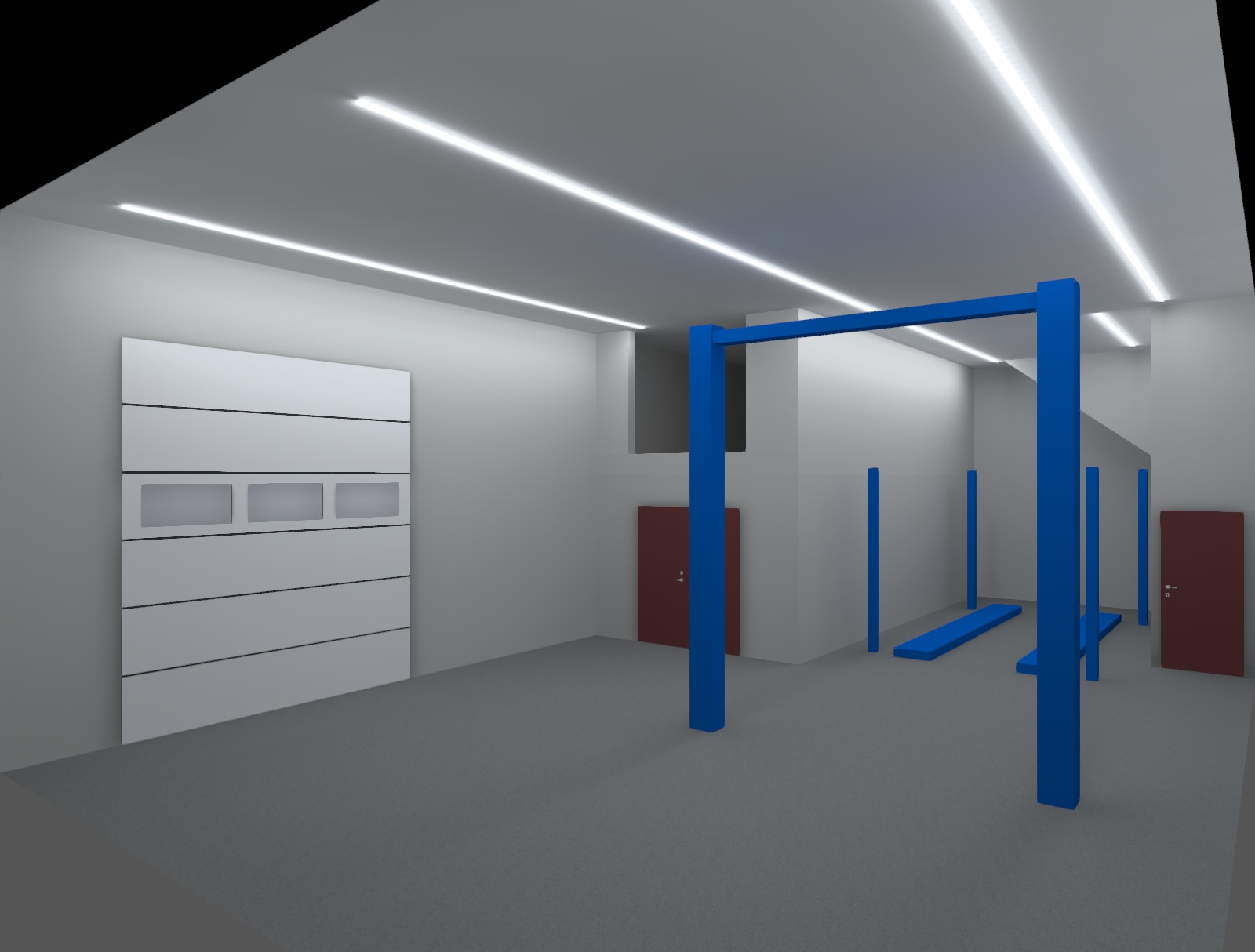

Was searching for light recommendations and came across this thread. Appreciate any input. Shop will be 24W x 34D and will be used for general automotive work and maybe some paint and body down the road.
Flat ceiling that are 12' with a tray at 13' 6" to allow for the lift posts. 2 post Bendpak 10A-LP.
Bottom half of walls will be light grey and top half white, ceiling also white.
I had spaced out 12 4' fixtures and planned to run them on 2 separate switches lighting every other light (1,3,5,7,9,11 on one and 2,4,6,8,10,12 on the other).
I was thinking of doing 4 lamp T8 fixtures with wrap diffusers but wonder if 4 lamps is overkill. Difference in price vs. 2 lamp is only about $300 total for the components.

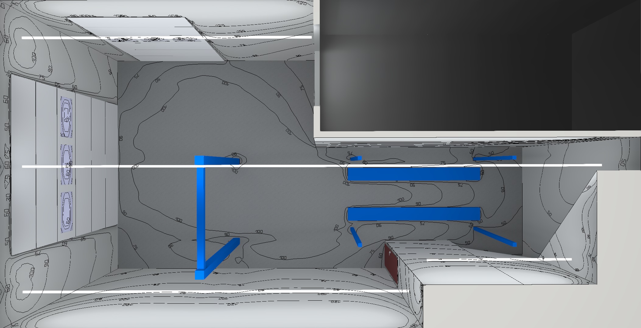

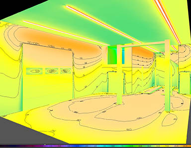

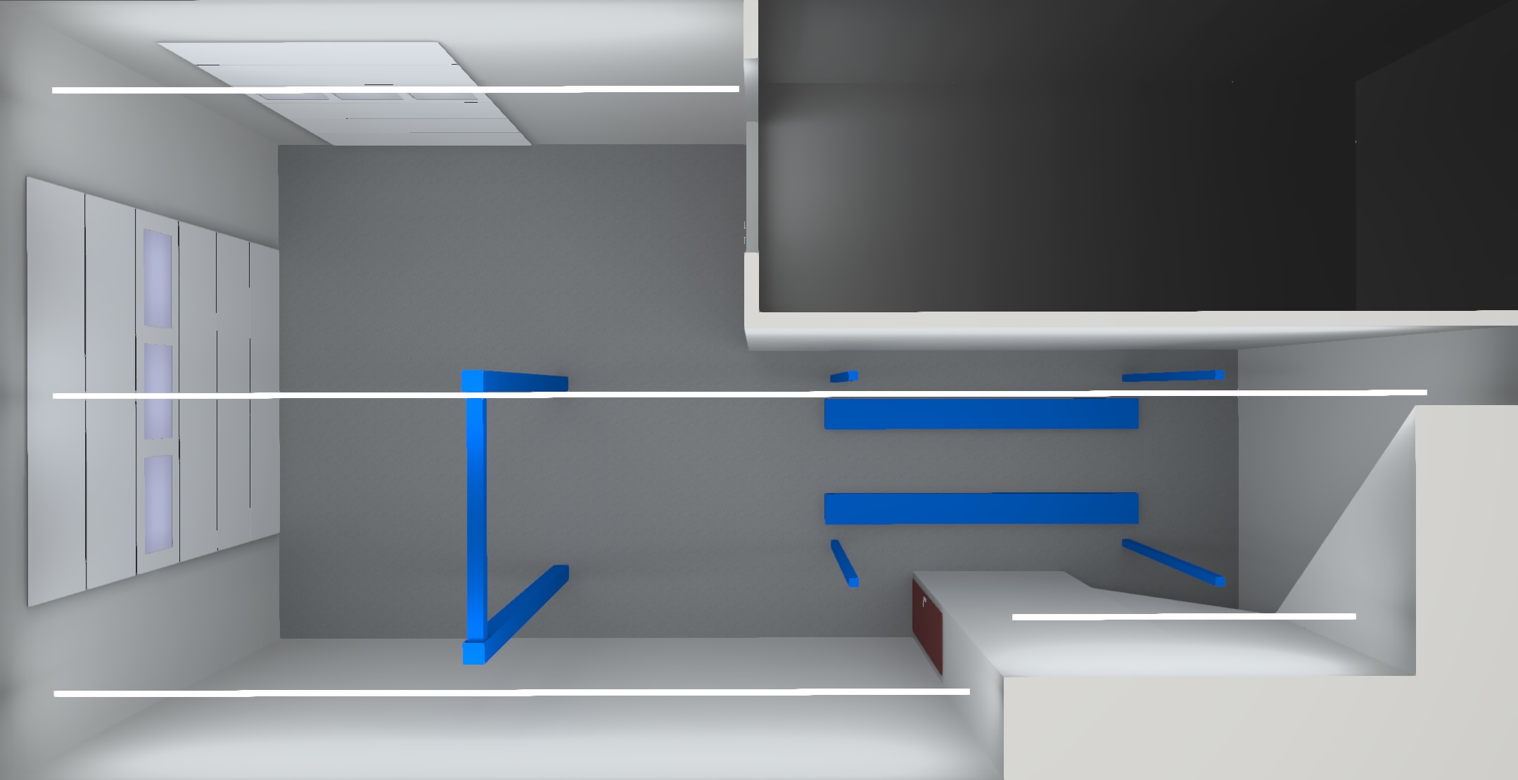

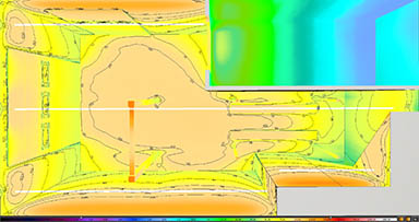

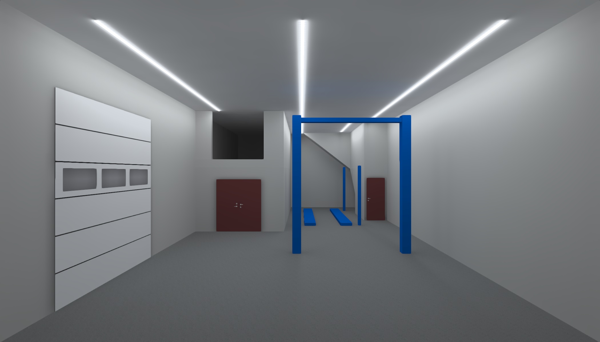

TTA89 26x51x15

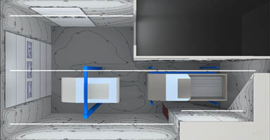

Layout Request:
Any chance I could get some help with a layout? I'm working on and restoring cars and would love some good light. I have 15 feet to the top of the ceilings. It will be finished drywall with the common white ceilings and walls down to about a 4 foot grey section at the bottom of the walls.
The 4 post lift in the front is mainly for storage and any work I do over there will be under the car. I'd say around the 2 post lift and the area in front of the workshop is where I'd mostly be working.
P
Platonic Solid
Nov 29, 2014
3,587
CT-USA

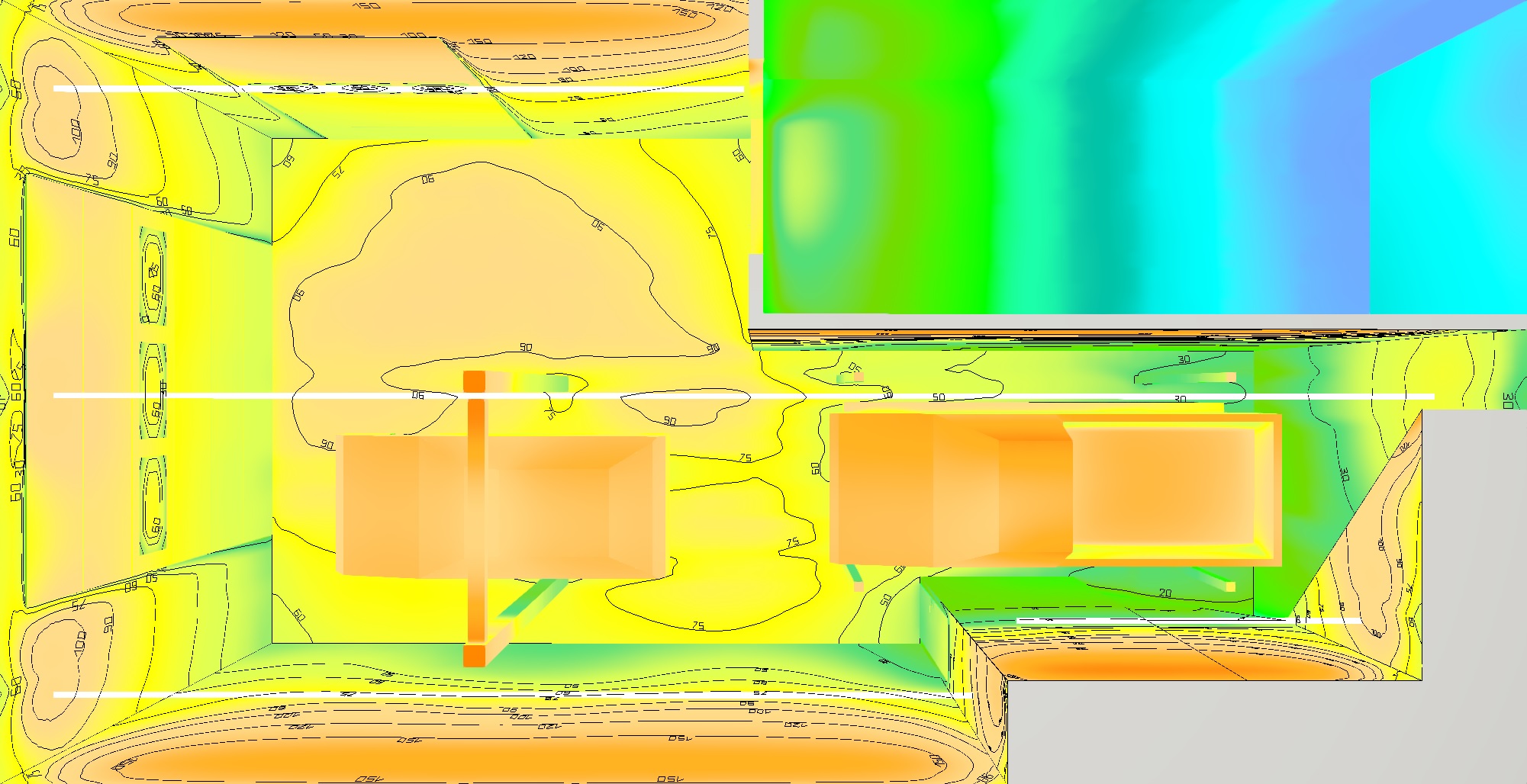

TTA89 26x51x15

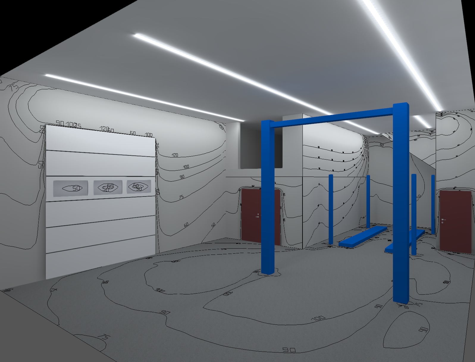

Qty.1: 2 Lamp F54T5HO strip light 46" long.
Lithonia Z 2 54T5HO MVOLT GEB10PS ($80 @ HD) ($65 @ Platt), Metalux SNF-254T5-UNV-EBT1 ($74 @ GoodMart), or equal.
Qty.14: 4 Lamp F54T5HO strip lights 92" long.
Lithonia TZR 2 54T5HO MVOLT 1/4 GEB10PS ($70 @ HD w/residential ballast or $100 w/commercial ballast) or Cooper Metalux 8TSNF-254T5-UNV-EBT1 ($83 @ Summit Elec. Supply), or equal.
Note: If you're willing to pay more for quality, consider special ordering fixtures with Sylvania or Philips Advance ballasts.
Qty.58: F54T5HO Lamps Sylvania 20949 F54T5HO 5000K $4.68 ea.
40-45,000 hr. lamp life per linked Sylvania spec sheet.
(Click all images for larger view)
P
Platonic Solid
Nov 29, 2014
3,587
CT-USA

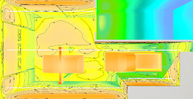

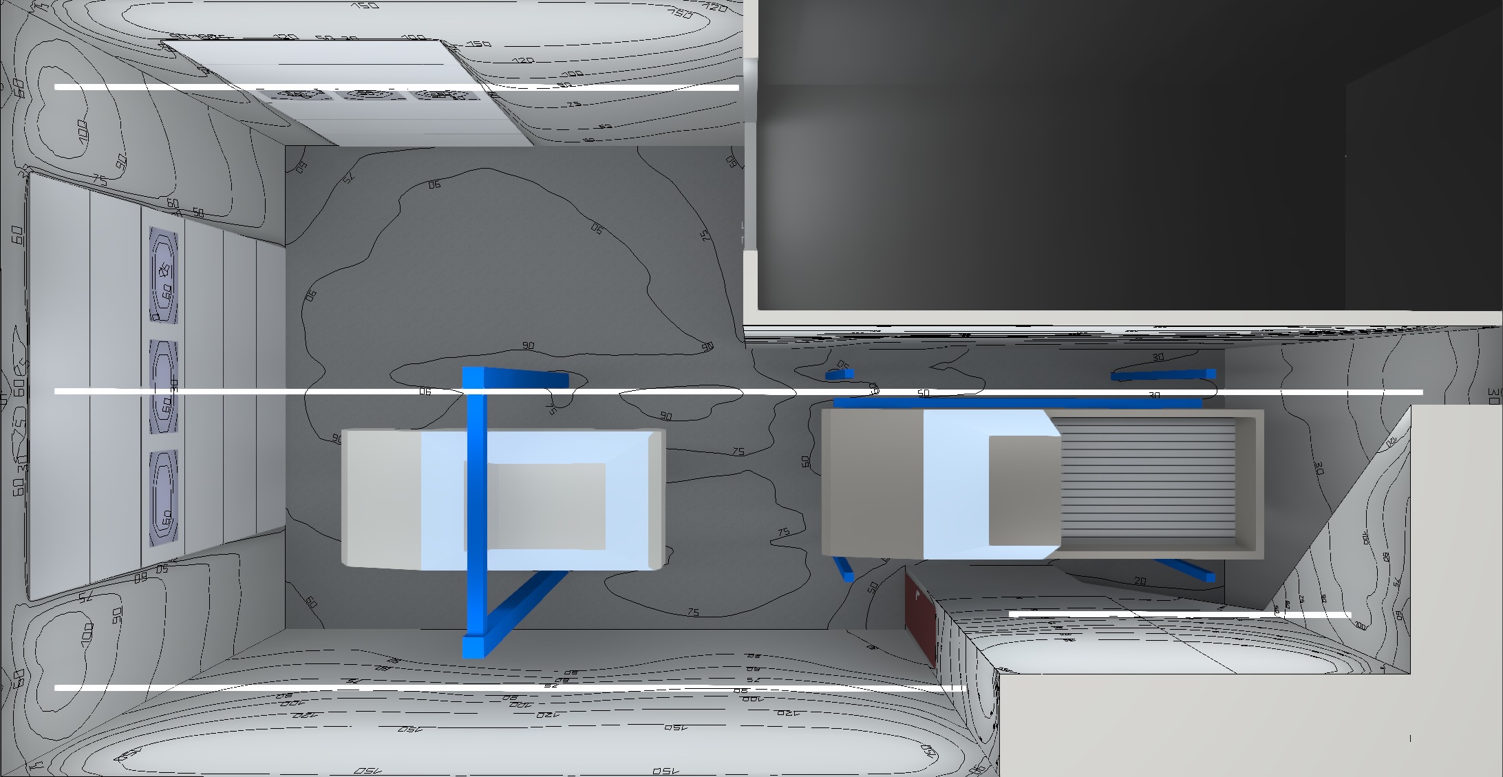

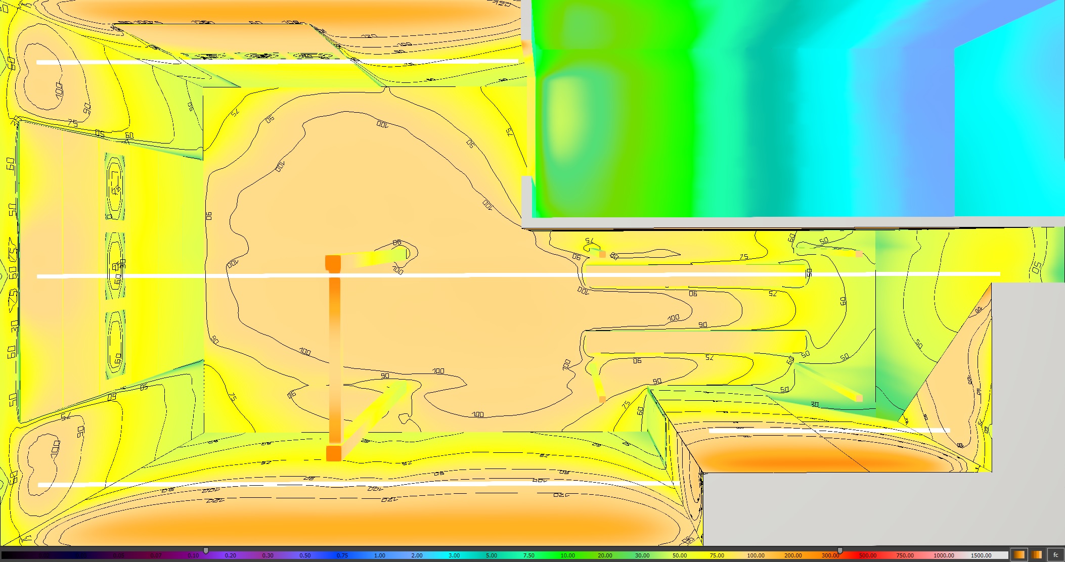

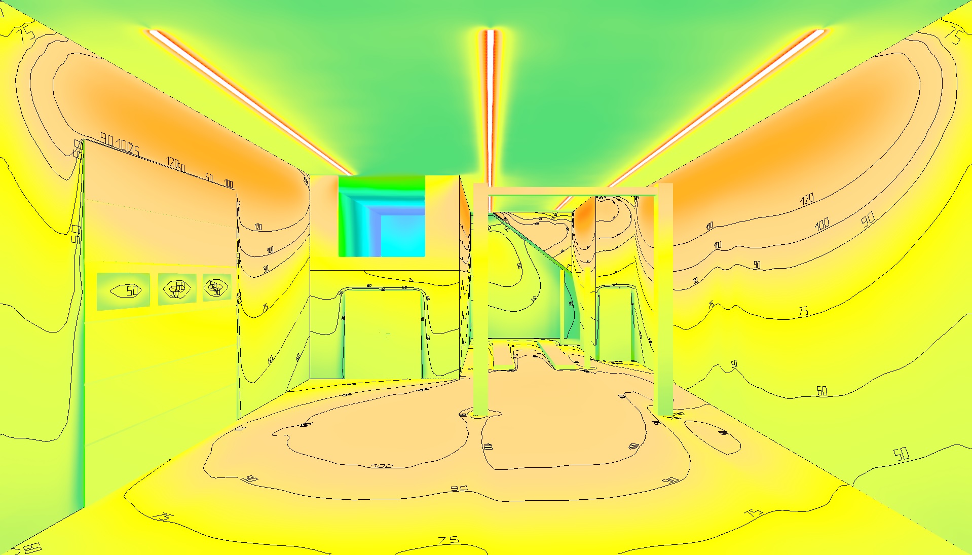

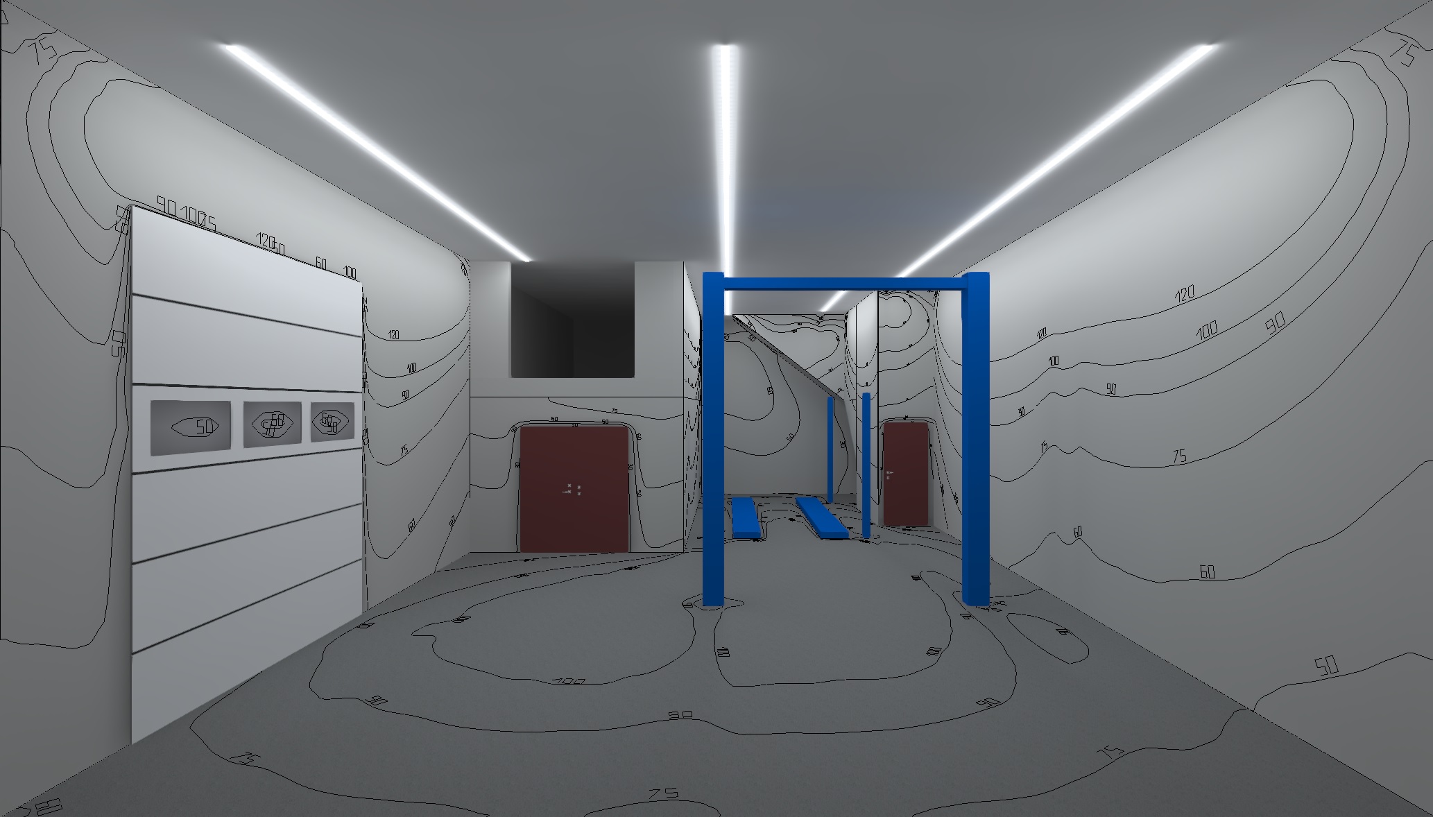

TTA89 26x51x15

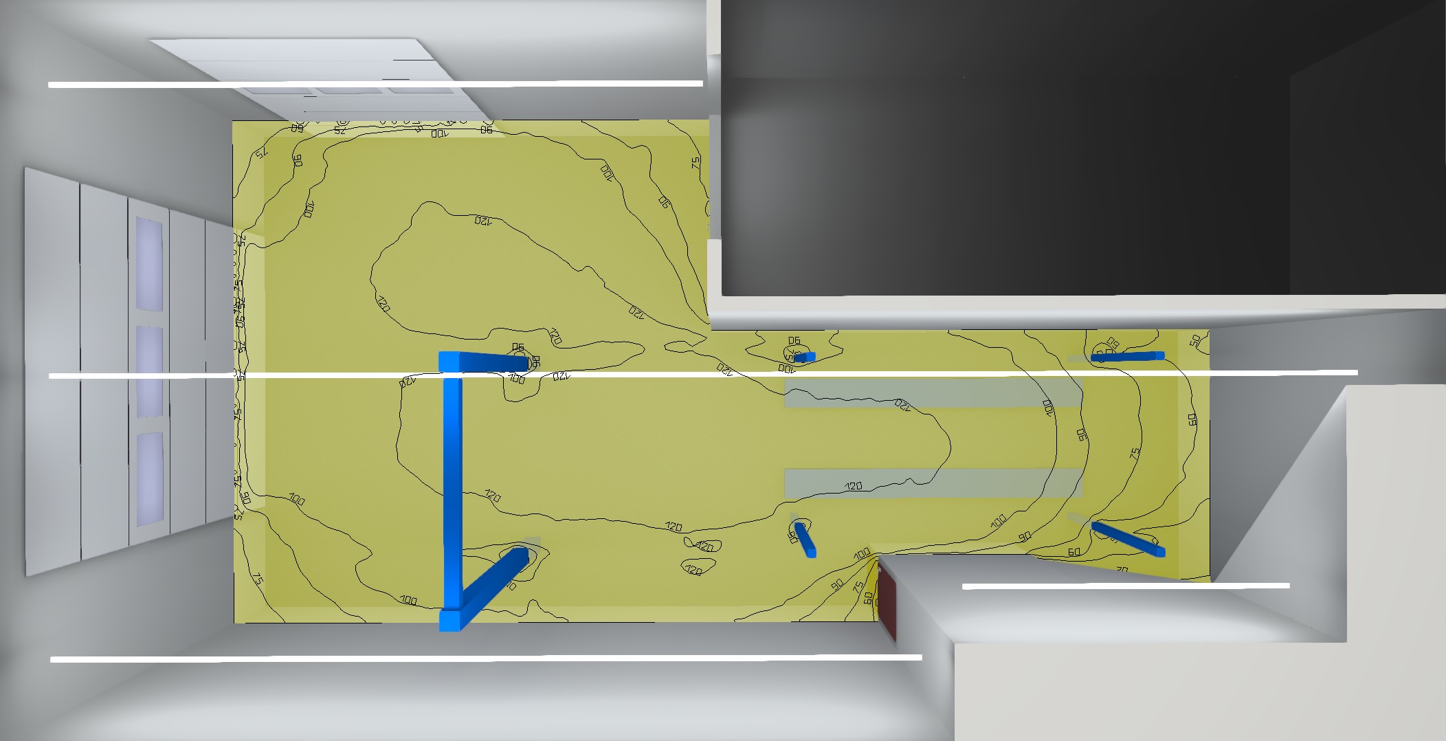

Above image = Fc @ 30" Workplane.
