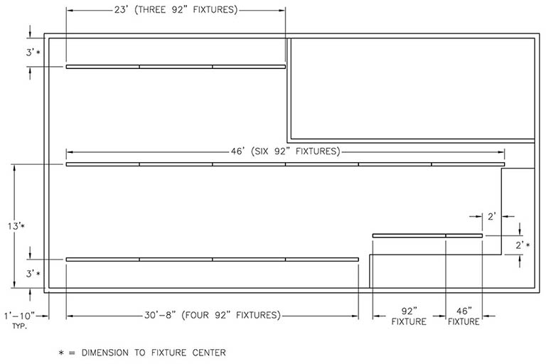

Re: TTA89 26x51x15
Suggested Fixtures and Lamps:
Qty.1: 2 Lamp F54T5HO strip light 46" long.
Lithonia Z 2 54T5HO MVOLT GEB10PS ($80 @ HD) ($65 @ Platt), Metalux SNF-254T5-UNV-EBT1 ($74 @ GoodMart), or equal.
Qty.14: 4 Lamp F54T5HO strip lights 92" long.
Lithonia TZR 2 54T5HO MVOLT 1/4 GEB10PS ($70 @ HD w/residential ballast or $100 w/commercial ballast) or Cooper Metalux 8TSNF-254T5-UNV-EBT1 ($83 @ Summit Elec. Supply), or equal.
Note: If you're willing to pay more for quality, consider special ordering fixtures with Sylvania or Philips Advance ballasts.
Qty.58: F54T5HO Lamps Sylvania 20949 F54T5HO 5000K $4.68 ea.
40-45,000 hr. lamp life per linked Sylvania spec sheet.
(Click all images for larger view)

Looks great! Seems bright. Are you going to have to remove the lights to put up ceiling?
CT
Yes the lights will need to come down but at least all the wiring is where it needs to be. I'm using the lights a raceway so there are only a few spots where the wiring comes in and out.
I was quoted 5K to do drywall without insulation that needs to be added and I have other priorities first... Like a heater so I can work on the car in the winter. Realistically, the ceiling is a few years off if I'm being honest with myself.

One thing I wanted to follow up with regarding T5 bulbs.
I needed 58 of them and I found this place http://www.globalindustrial.com/ that sells them 40 to a box for $110 plus shipping (9 bucks to NH). I ordered 1 box so I could make sure they looked good and all that. Here is the actual item I bought:
http://www.globalindustrial.com/p/e...inear/20949-flourescent-t5-fp54-850-ho-eco-t5
The box came and was wrapped well, no issues. I was actually surprised how small the box was with 40 lights. So I placed a second order for another box a few weeks later. The second box was not wrapped like the first and it looked like Sylvania changed the packaging as their box was different. I opened it up and about 10 of them were broken. :( Luckily I only needed 18 good ones to finish my lights.
I took some pictures and sent an email off to customer service asking if they could send me 10 replacement or just credit me back for the 10 broken ones.
I received a reply today and it sounds like they are going to send me a new box with 40 bulbs AND credit me back for the entire box of broken ones. How awesome is that?! Will I order again? Hell ya :)

Hi Revamp,
I used the Lithonia 8 foot fixtures from Home Depot. It should be these fixtures - http://www.homedepot.com/p/Lithonia...ture-TZR-2-54T5HO-MVOLT-1-4-GEB10PS/202516724
For the cans, I just picked up a box of IC rated 6" cans and put LED replacement light bulbs. I think this is the box - http://www.homedepot.com/p/Commerci...rtight-Housing-6-Pack-CAT7ICATA-6PK/202256649
I wired my T5s into 3 switches and I put them onto 3 different circuits. I didn't really need to do that but I had the space in the panel, so why not? That way if I blow a breaker I'm not in the dark. The cans are on two switches on two circuits, the circuits were installed before I bought the place. I turned the "hanging light bulbs" into cans and added a few extra. They work well if you need to run in and grab something or whatever but they are useless if you want to work out there.

We are breaking ground on a 36 x 60 workshop/ranch shop next week. Im struggling with the lighting plan (effectiveness of the lighting around the 3- 12x12 roll up doors, and so on...
It's pretty much wide open inside except for the long wall with only windows (3 30x30), that is reserved for work benches/tool chest, welding table, etc...
The end gables will have 1-12x12 roll up, and 1- 30x70 man door each. with 2 30x30 windows. The opposite long wall will have 1-12x12 roll up (centered) and 1 man door (30x70), and 2-30 x 30 windows as well. Outside lighting is preferred to be large commercial type dusk till dawn security lights, with farm style porch lights near man doors. There will be a gutter system in place as well as a 2ft. soffit on the long sides, and a 1ft. soffit on the gabled ends.
I added 4 screenshots

After reading all of the outstanding info on this thread, I'm looking for a little help. I would like to play around with the visual 3d tools but there is an over whelming amount of lights to choose from. Does anyone know the best match for the Max light fixtures and matching 5k bulbs listed in the "best lights thread"
http://www.ledlightingwholesaleinc....ady-Linear-Utility-Strip-p/lss2xt8use4803.htm

Re: gt1guy 50' x 80' x 18' (16' Walls)
Qty. 37 Lithonia TZR 2 54T5HO MVOLT 1/4 GEB10PS
or Cooper Metalux 8TSSF-254-UNV-EBT1 or 8TSNF-254-UNV-EBT1.
HD's $70 price tag for the Lithonia is hard to beat. Might want to open one and see what brand ballast is in there before buying 37 of them. I see HD sells what appears to be the exact same fixture without the "R" designation (I assume that means residential), thus TZ 2 54T5HO MVOLT 1/4 GEB10PS for $100.
Qty. 148 Sylvania 20949 F54T5HO 5000K $4.68 ea.
The 30,000 hr. life on the site is wrong. The most current Sylvania spec sheet (linked) says 40-45,000 hrs.
I linked to this bulb on a prior layout at $3.80 ea. from 1000bulbs dot com, but that may have been an error on their part as they now don't carry it at all.
(Click all images for larger views)
fc plots at 30" workplane height. Average illuminance = 94fc
Well, I finally got power turned on today. All I can say is wow. I couldn't be happier with the results of your recommendation for lighting. It is exactly what I hoped for. Now shadows. Even light everywhere. No glare. Words can't describe how happy I am right now.
The only change I made was where the office will go. Not sure when I'll get that done, so I put two fixtures where you said to put the singles. Which is what I figured you'd say to do if the office wasn't there.
Each bay is on it's own switch, so I don't have to run everything all the time.
I ended up getting the bulbs from Global Industrial for $2.75 a pop.
http://www.globalindustrial.com/p/e...3fK1vcYCFVYTHwodvF8HFA&PID=6147012&CMP=AFC-cj
So, Platonic Solid, thank you so much. You da man!
