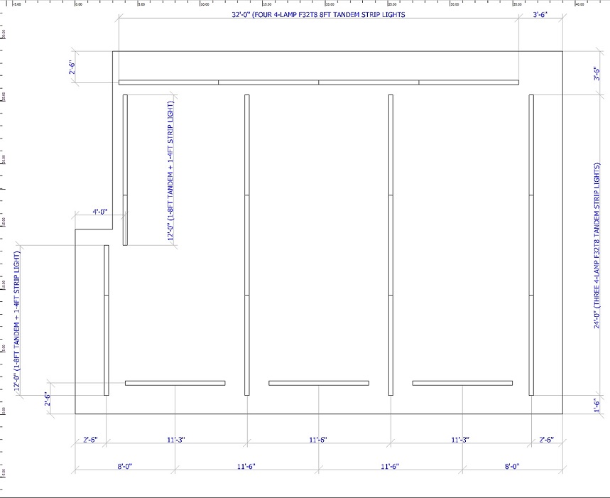

Re: roadrunner255 36x40x12, 2/12 Pitch 15' Peak
roadrunner - I experimented with multiple fixture and layout options and turns out the best one was the first one. The Cooper fixture you linked to is a good price for a good fixture. The layout dimensions may not be exactly where your purlins are. The closer you can come to the layout dimensions the better the results will be. All fixtures in layout hanging 1.5' from ceiling surface.
The Lithonia fixture I used is basically the same as the Cooper. Cooper doesn't have an 8ft IES file.
Here's the Dialux report (linked)
Image linked to larger view.
Any issues with the lights not being 1.5' from the ceiling? Overhead doors will interfere with the lights. The lights can only hang down 6" from the perlins, so 12' 3", 13', 13'9" for the first 3 rows.
Thanks!

roadrunner255 - assuming purlins are 8", then 6" from the purlins = 1.17ft from ceiling surface. That's only 4" difference from the original 1.5ft from ceiling surface suggestion. I tested it and it only changes the avg at workplane illumination from 86fc to 85fc. You're good to go.

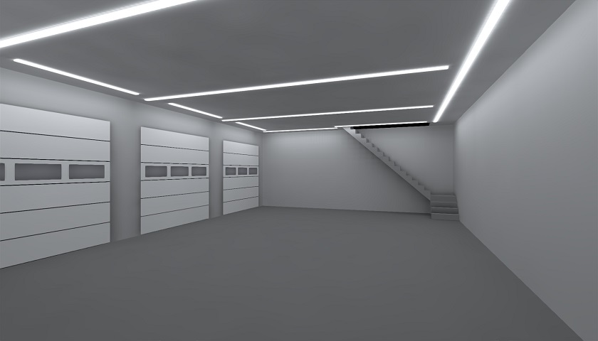

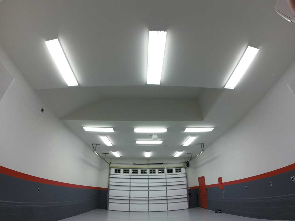

Re: INTMD8 35 x 46 x 15' peak 4.8:12 pitch
Even though I've had to mostly stop doing lighting layouts, I couldn't resist the unique design INTMD8 came up with.
The main lights are up, thank you again!!! Looks great.
Had to change the layout for the lower ceiling section as the garage door and attic stairs were in the way. Put up 8 4ft led's but they aren't wired in yet.

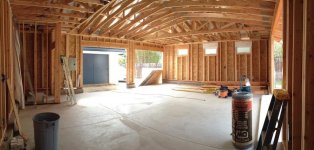

Hi everybody. My first post!
Thank you Platonic for this info-packed thread. I've learned a lot by reading your posts here and also the lighting fixture sticky.
I'm building a 32' x 25' garage workshop in SoCal that is divided into three areas. The left side will be for parking and light-duty maintenance. It has a 9'9" flat ceiling that will be drywalled.
The middle section is 15'6" x 24'6" and has vaulted trusses that rise from 9'9" to 11'6" at the peak. I was planning on leaving these trusses open. There are two skylights in between trusses now. This section will eventually get a 2 post lift.
The right side has a 9'9" flat ceiling that will be drywalled. This area will be for a workbench, tools, cabinets, storage, etc.
I would like to go with LED strip lights but I'm still not sure how to deal with the differences in ceiling heights and the vaulting. Maybe it's too small to make a difference but I've never done any kind of lighting layout so any and all advice is appreciated. As I've gotten older I realize how important good lighting is so I'd like my first workshop to be a clean, well lighted place for working on cars, woodworking projects and making and drinking beer!
The walls will be drywalled and painted a light color. The floor will be getting an epoxy like finish with flakes that will be white, blue and black. It might be a little dark.
I've included an interior photo taken during construction that shows the flat and vaulted sections and also a sketch with interior dimensions.
I realize everyone's probably out shopping, but if you're avoiding the crowds and want to help a newbie, it would be greatly appreciated.
Happy holidays.
-Terry

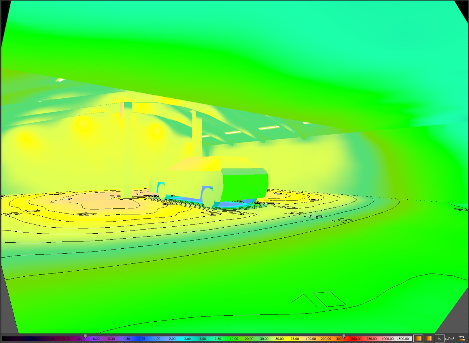

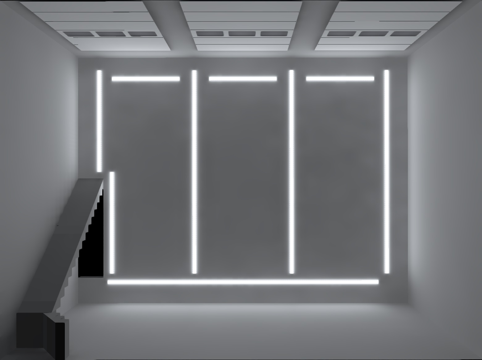

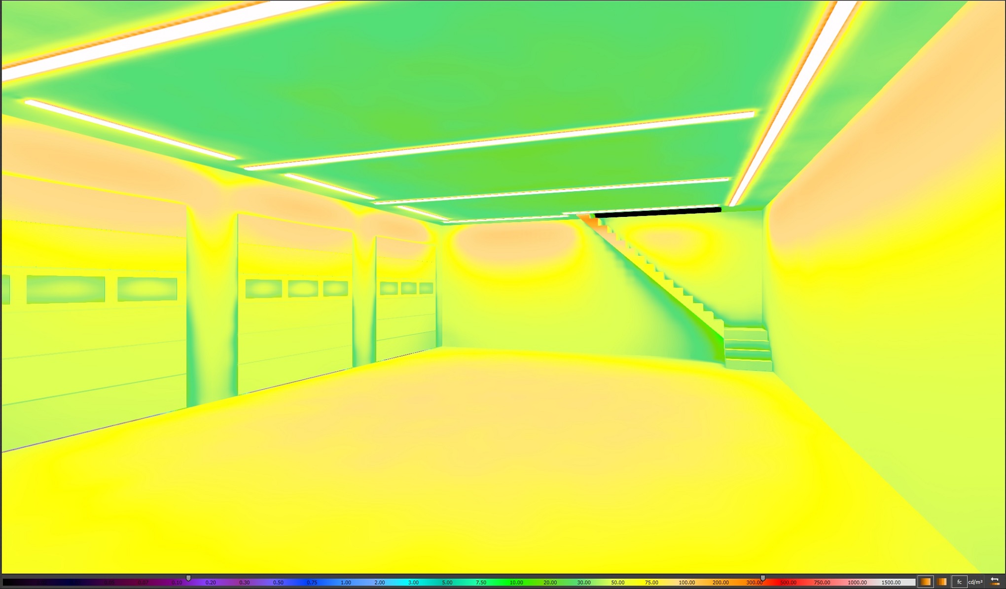

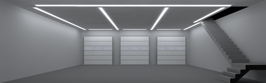

Pictures are great, but since they're a poor indicator of actual light output what really matters is your visual experience in the space. Is the lighting good for reading a manual or rebuilding a carb? From the picture, it appears the rear of the Ferrari needs the light from the 8ft area.
I know you're not done, but as a guide, here's your space without any fixtures in the 8ft area and a car parked with rear about 2ft into the vaulted ceiling area.
Very neat! Your photo matches my perception of what's going on there. Agreed the back of the car needs light from the 8ft area if parked in that spot.
When I was hanging the lights (before they were fired up the first time) I was thinking I was going to need more lights around the perimeter or over the tool box but now that they are working it seems perfect.

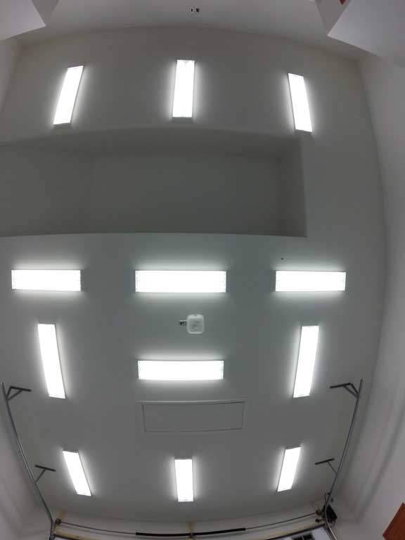

Here are a couple shots from a GoPro of what the computer model suggested and how my final implementation turned out. Fixtures are Utilitech 4 foot 4 bulb T8 with Phillips 840 class bulbs. Ceilings are 12'.
I had to make some slight adjustments in orientation for the pull down ladder and recess for lift.
Got the bulbs on clearance for $10 a box of 10 at Home Depot which helped A LOT on the cost.

Hi PlatonicSolid,
Right before Christmas I posted #216 here. Since then I've tried to get DIALux working, but being a Mac/unix guy I don't own Windows and unfortunately the wine windows emulator failed to run DIALux.
Based on other layouts in this thread, attached is my rough placement of 4' fixtures. In your opinion, would using the James bulbs in this layout work? As I mentioned in #216, the left bay is for parking and light maintenance, the center bay (which has an open, vaulted ceiling) would be for automotive work on a lift and the right side will (someday) be a general purpose workshop with cabinets, workbench, tools, etc.
Using the sketch as a reference, the attached photo was taken from the top right looking toward the bottom center where the two garage doors are.
What do you think? Any guidance very much appreciated.
