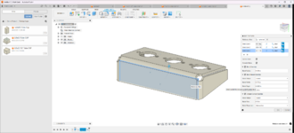

Playing around with Fusion in prep for making sheet metal parts (once I have the plasma and press brake up). Fusion is fairly intuitive but I'll need to play with real parts before I can better understand how it works for real. Also, I kinda expected there to be more configuration adjustments but we'll see if it matters once I get to bending.
Here's an example: in the picture above, using "Start" for the bend line position I had to add little extensions to get to a weldable joint (where the wings fold into the main body) which makes very little sense to me...deviates from the value of CAD/Software.
To me it seems like I should be using "Center" but if I do the wings collide with the part and I get an error.
I don't see an override that will enable me to adjust this collision either. Any ideas?

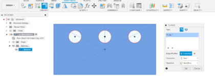

This is how I would make this part. Maybe it will help.
Start with the base flange sketch:
When the sketch is all black lines, it is fully defined/constrained. Next use the flange tool to turn that sketch into a solid. The reason to use the flange tool is the thickness is based on the sheetmetal rule. 14ga CRS using the 1/2" die in my case.
From there I pull three flanges from the bottom edge of the base flange. Note I've selected "Two Offsets" for each flange.
On the long edge I use a negative offset of the material thickness. Also note that "miter corners" is deselected, and the relief shape is changed to tear.
Then on the two sides I use an offset of 0.001":
This closes the corner, leaving a 0.001" gap. Then make a flat pattern:
The resulting flat pattern:
The aqua colored lines are the edges of the bend radius, and the center is the bend centerline. To give the sides the angle, make a sketch on one side:
Extrude through the part:
Updated flat pattern:

The resulting corner detail:
This kind of part doesn't require welding, generally speaking. We do weld parts like this when the project warrants. It's a quick fusion weld with little if not any filler.
Thanks Stephen. So in this case you're using a flange instead of a bend. That would be why I don't have an options other than "Start", "Center", and "End. Flange can work but based on how it's utilized, it seems like it's not technically part of the part. Meaning, what happens when your model has multiple connected bends that fold up into the entity? I do agree however that this is a much easier way to do what I was trying to do. Makes sense. I'll see if I can add a flange to a flange...
