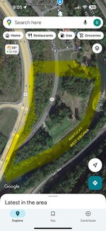

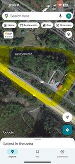

Have you guys even looked at the pictures the OP posted? I don't understand why he needs a $30k tractor for mowing grass?

Quote from post 2
"About 8 acres between 2 properties"
If he has 8 acres the pictures don't show all of it.

Do you need to trailer it between locations? That may be a consideration for size too unless you have a big trailer and truck already.
There doesn’t look to be much “lawn” type mowing there. I’d skip the idea of a belly mower and go with a flail or rotary cutter.

Less than a half mile in between them. Belly mower is probably out after thinking about it. $3k for one and I can buy a garden tractor for $2k that would last 10 years. I am buying a 18ft trailer though.

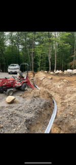

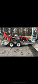

i have a massey gc2300 that I've put around 2000 hours on over the years. It has been a great tractor but as the others said anything under 30hp and they are pretty much a ride on lawn mower and really cant do anything other than mow a small backyard. i would also suggest the 20' or even 24' trailer because it doesn't fit at all on a 7x14
Nonsense. I have used my BX23s for clearing several acres. Moving 20 tons of gravel. Grading land and grading a driveway. Clearing my 1000' long driveway of snow. Moving hundreds of yards of mulch. Making a 1/4 acre garden plot. Moving pallets full of tile. Unloading heavy shipments from box trucks. Moving building supplies. Skidding trees. Moving wood. All with under 300 hours on the machine.
I mow with a zero turn.
manwithtools
Aug 24, 2015
14,298
Lebanon, TN
I think you missed the obvious sarcasm in @njk4o5 post ;) . Take a look at his included pictures.
