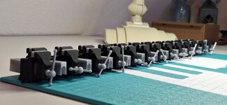

Slowly sneaking up on the final tolerances for these little guys. I placed the hardware order from McMaster Carr this morning now that I'm confident in the scale of the parts printing well. For reference, the jaws are 13/16" wide, it's tiny! Kind of an odd size, I know, but it's just the way the proportions worked out. It's pretty neat to have a less than 1" bench vise!
I'm currently printing what I hope is the last round of prototype parts. I just made a couple of small tweaks that should align the jaws better heightwise.

I built a small army of them! They assembled really well and I'm quite pleased with how they turned out. They are available on my website here right now if anyone is interested in ordering one. Thank you for looking.

For anyone that ordered a vise and was within order #10011-10027, I dropped your package off at the post office this afternoon. Everyone else who placed a pre-order, I'm currently printing them and will get them assembled just as soon as I can! Thank you all who decided to order a mini vise, I was absolutely stunned and grateful with how many sold yesterday!
Here is the first batch strapped down to their little cardboard pallets, ready to be put in their boxes.
If you want one, there are a few vises left in the second batch pre-order that I'm currently printing. I will assemble and ship the second batch before starting the process again for the third round. You can pre-order any time on my website: www.madebymillerllc.com
