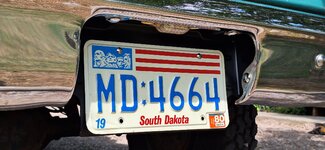

This past weekend I scored a really neat bicentennial South Dakota license plate at the threshing bee flea market. It looks right at home on the truck.

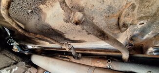

I also took care of a couple of items I noticed while under the truck mounting the bumper - some loosely hanging wiring and a failed passenger side exhaust hanger. Feels good to keep chipping away at the to-do list.
83VillageRepair
Aug 17, 2007
771
Merkel, Texas
If you come up with a 72 plates you can actually register it with the plates. Did you go to the threshing bee in Sturgis? That is always a fun time. If you decide to fix it I have a much better cab in my junkyard in Edgemont.
Thanks for the heads up and the cab offer! These plates are just a neat touch for listing photos really. I'll take the plates off when it sells. Yep, the threshing bee in Sturgis. We've gone every year for 4 years now I think, the kids really enjoy it (and me too). Have an idea of what you'd want for that cab? I'm not interested in doing a cab swap, but it might be useful to pass on to potential buyers of the truck.

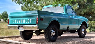

I was able to get a couple more items checked off the to do list on the '72 over the weekend. First I made a slight adjustment to the hood alignment and now the gaps are more even and the hood pops open much nicer. Then I scraped off all of the loose undercoating under the hood, sanded it lightly, and gave it a few coats of satin black paint. This was a huge transformation as you can see, and I'm really glad I took the time to do this.
Before:
After:
I also polished the front bumper which was quite a transformation as well, even if it doesn't really translate to photos. Finally, I cleaned up and installed the neat older Wyoming license plate which originally belonged to my wife's late grandfather.

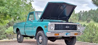

The little things indeed @OutlawDrifter
Today I did a few little things. I took off the bowtie that was looking quite sad, and I stripped off the black spray paint I had applied back in highschool. Unfortunately, my paint stripper was a bit too aggressive and ended up eating into the plastic of the badge. To bring it back I had to sand the face and polish it back out. It's not perfect, but nothing on this truck is so I'd say it fits in just fine.
Before:
After:
Afterwards I went around and quickly polished the remaining bright work on the truck, including the grille surround, rear bumper, mirrors, hubs, and door handles. The little things.

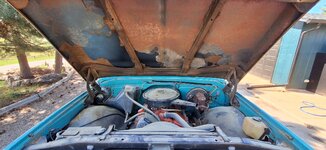

  • Detail engine compartment

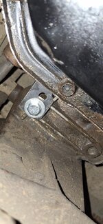

Today I managed to check off 3 items from my to-do list for the '72. I ******* the fuel lines, sanded and painted the air filter housing, and painted the hubs. I've been using Google Tasks for my lists and I really like the convenience so far of having it on my phone and computer.
Fuel lines (and brake line):

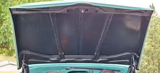

Muuuuch better with some semi gloss black:

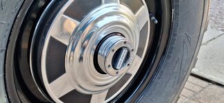

Hubs looking much better too, even if you can only barely see them with the hubcaps on:

Well, yesterday did not go to plan. I couldn't get over not knowing if replacing the vacuum modulator and verifying that the valve was not sticking would fix my shifting issue, so I decided to replace the modulator and pull the valve. I wanted to take the old modulator off first and bring it with me to the parts store to make sure I got the right part. This is where things started to unravel. There isn't a lot of space in my truck to access the modulator hold down bracket bolt, so I had to try various wrench lengths and ratchet setups to get on the fastener. When I finally got a good setup, I was shocked at how tight the bolt was. Then disaster struck when the bolt finally "broke loose" which was really just the head of the bolt shearing off. Great...
I wouldn't say I was happy to have broken that bolt, but it doesn't do any good to get mad in that situation, so I just kept working. I pulled the modulator off and with the help of a small pair of needle nosed pliers and a magnet, I got the valve out from behind the modulator as well. A visual inspection showed no burrs or nicks that would cause the valve to stick. The fluid passages were not clogged either. At this point I realized that I had done nothing but waste time and rule out the sticking valve (which I didn't really think was the problem anyway). Feeling a bit defeated, I moved on with fixing my screw up.
There was zero chance that I could drill out the broken bolt in the transmission due to lack of access. My mind went through the possible fixes and none of them were easy or viable. It was then that I turned to the internet for a potential solution. That's when I found this bracket which is designed to relocate the mounting point of the bracket elsewhere on the transmission. This is what I would have to do!
Using a piece of an exhaust hanger I had in my drawer, I created the mount you see here that ties to one of the transmission mount holes on the bottom. I ended up getting pretty lucky and nailed the alignment of the bracket with only a couple of test fits. Time will tell if it works as good as factory, but my test drive revealed no leaks around the modulator, so I'm calling it a success for now.
In the end, I didn't even replace the modulator and I don't think I will at this point. I'm assuming that the shifting problem is in the valve body and I am not interested in dropping the pan to investigate. All in all, not a good day yesterday, but at least it's all back together and no worse than it was before.

On dissimilar metals I’ve found the the great philosopher Beevis is right…
”Fire!!! Fire!!! Fire‘s Cool!!!” A little bit of road salt mixed with steel in aluminum is just a very bad combination! Some heat and a squirt of Kroil or other penetrant saves many hours. And it doesn’t have to be a lot of heat, just enough to expand the aluminum more than the steel usually does the trick. YMMV!
Yes, after I broke the bolt I felt stupid for not applying heat when realizing how tight it was. Live and learn.
