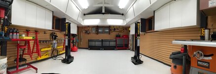

Hey folks,
Wanted to get everybody's thoughts on this - I had MaxJax installed from an installer I found on their website about a week ago - and I've noticed cracks in 3 of the 4 corners on one of the posts:
Installer told me he's not concerned - but the other post is fine and showing 0 cracks.
They checked the concrete during install after drilling and mentioned it was thick enough, but did mention one side of the garage was thicker (the post on the thicker side is showing no cracks so far)
Thoughts? Is this something I should be concerned about? Or is this par for the course?
Thanks!

Zoomed out picture showing the control joints:
If I had to guess, they look more like the the "tool joint" from diagram below:

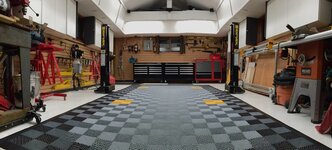

Hey all - thank you all so much for the suggestions and recommendations. Wanted to give a quick update
- Ended up following some of the advice here and just cut the slab and repour'd 2 footings. 4x4, 12inches deep
- When they cut the slab where the concrete was cracking... it appears there was a local thin area that was only 4 inches thick
- Oddly enough, it looks like there were 2x slabs that were 4 inches each?
Also added rebar, finished product:
All in all, I'm glad I ended up cutting and re-pouring. Worth it for just the peace of mind IMO. Put a few cars on the lift, and no cracking yet haha.
Thanks again all.

Nice man... I'd be tempted to paint those new concrete squares black and red like your race deck :)
Denwood
Sep 22, 2014
4,233
Thunder Bay, Ontario, Canada
@IMC ,great job. That extra margin of safety when lifting is something you'll never regret!
You may want to throw a few target tiles in there for the lift. I find the yellow tiles quite useful when lining cars up for the lift. Every vehicle is different but you can note where each should be for a balanced lift in relation to your target tiles. I just placed the tile squares (4 tiles each) equidistant from the lift columns, based on measuring a few different vehicle's wheel base. I use them every time I place a car for the hoist.
