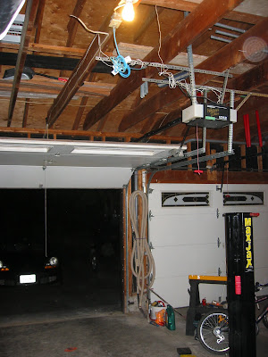

Last night, I spent a couple hours to move my normal trolley garage door opener from it's center mount, to the side of the door. According to the Chamberlain manual (Our house has the WhisperDrive opener), you can offset the opener by up to 4' from center. This should give me enough clearance for most vehicles to be at full height on the lift, some like my Boxster and Jetta should be able to be up on the lift even with my garage door up. Currently, I only have the standard lift tracks on a 7' tall door.
Pics are here:
http://peterchang1.blogspot.com/2011/08/blog-post_08.html
