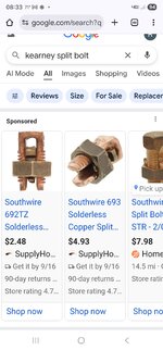

Please elaborate for those of us who aren't electricians
Codyboy
Jan 31, 2019
1,781
S.E. TEXAS
Kearney split bolt. Or just split bolt. Or damned electricians clamp. Lol
Around here they are (were) used a lot by electricians to connect the service entrance wires to the POCOs drop when they wouldn't pull a permit if needed. (Bootleg job)
Seems at least a couple times a month I'd find one burned up .
Mostly because they'd use a copper split bolt on aluminum wire.

Ok, why would an electrician use split bolts on a service instead of a crimp?
Split bolts are usually what you see an owner do on their own stuff, because they don't have the tool for a crimp.
