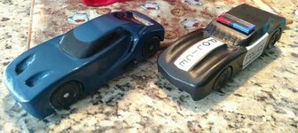

That's cool to share your tools and talent with those who don't have the tools of their own.
My dad even lathe turned the tires and applied graphite to the sides to get the weight just right. It came in second to a kid whose car looked like it was carved with a broke Barlow knife. We alternated lanes and it still came in second. A couple weeks ago my brother was helping dad clean the attic of the garage. They found two of my cars. Time and heat has taken it's toll and ones paint was flaking off.
I
IPACA9
Jul 18, 2013
489
Independence, Mo
I still have the car my father and I made when I was a Webelos 32 years ago. I'll have to take a picture of it.
I have three boys ages 10, 7 and 3½. My older boy will be crossing over to Boy Scouts this Saturday. We will be making cars for a long time. My second boy started this year and his little brother won't be long behind him. Last year I was a Webelos Den Leader but I became the Tiger Leader with my boy. We now have Adult, Family and Siblings classes for the Pinewood Derby so everyone can enjoy. We also have a new aluminum six lane track to speed thing up a little bit with all the entries.
Sent from my XT1585 using Tapatalk

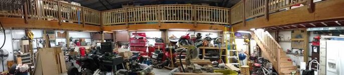

For my railings I decided to go with cedar. I already had some balusters that I bought a year ago that I had to sand down to make look fresh again. I got them for 50 cents a piece but were weathered a bit. That was a lot of work but worth it in the end. They are non-cedar but I may stain them later. I made a jig that made it a lot faster to put the balusters in with 4 inch spacing to stay in code.

This came out so well it should get "pinned" as "How to do a mezzanine the RIGHT way !"
Looks great ! Have fun in there with the boys !!
Thanks. It's been a long road and I thought I was done...lol I've already started to design the extension on it. I would be adding about 11 ½' x 23' to it. 09d07b5371a3b163087008087888f396.jpg
