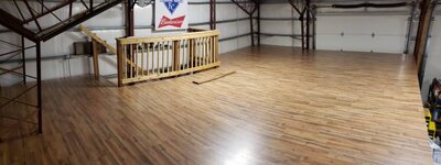

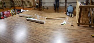

Sorry for the delay. Just a lot of life going on. I finally started moving on the shop again.
A buddy came over Saturday and didn't flooring for me. He does it for a living and knocked it out in a just a few hours time. I would have taken me much longer. Now I need to get everything up there and mount the railings. Also redesigned the layout.

Interesting setup with that door in front of half the second floor. I guess the mezz wasnt in mind when the building was first built?
Kaizen
Jan 9, 2015
6,946
New England
might want to put a stop on the railing side of that laminate floor. depending on quality sometimes the joints separate if there is any flex in the floor.
I'm putting a 1x3 on the end and then some 1/2 or 1/4 inch thick on top to make a corner moulding over it. With the thickness of the flooring, underlayment and 3/4 subflooring the biggest corner moulding I can find locally is 1-1/4. Just doesn't do the trick.

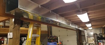

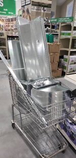

About a month ago my buddy sends me a text with jus a picture of the furnace and A coil. I hit him back and ask if he meant to send me that. He says "you need this in your shop and I need a remote starter on my wife's truck". DEAL! He had just removed it on a house that they were upgrading and its already setup for propane. A few days ago I got tired of looking at it and I've been so busy I called him and asked how much he would charge to install it for me. He said he just bought another vehicle and needs another remote starter. DEAL!!! Took him about three hours to do. Would have taken me much longer.
Tonight I'll add the last duct piece. Add five vents and I'll have heat that doesn't make me smell like kerosene or propane. I've got two 72" fans to put in the roof here in a couple days and it will get the air circulating.

Finally got out to the garage late last night. At 2am I got the duct and vents finished. Cant wait to get the ceiling fans up and get that air moving. Definatly will keep the furnace from cycling so much. b481b58f6e4f934997ab9134ef1e900e.jpge7d2066971e857c34b38028e59e6899a.jpg

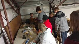

I realized reading this that I hadn't posted pictures of last year's workshop. It was a couple days after I had finished the railing before I decided to add onto over the bay. My buddies that are also on GJ always say I should create a Garage Gallery post that will show the ongoing projects and even the past things that I've done with the shop, the house, the yard and other buildings on the property. I always have something going on. I might sit down on night and type up something.
Heres some pics of last years Pinewood Derby Workshop. Throughout the day I had maybe about 60 people come through to build cars for themselves or their sons and daughters. We have several categories for scouts, siblings and adults.

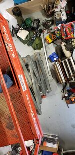

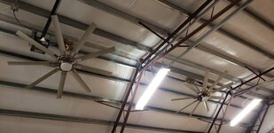

Been working my *** off on the shop this week since tomorrow I'll be hosting our Pinewood Derby workshop again. Last Saturday I rented a Skyjack so I could install my ceiling fans. I went with the 72 inch 9 blade Slinger V2 fans. I had my 13 yr old son helping me put the blades together while I was installing the fans. It was late and he passed out on me. He had a long day helping a fellow scout with his Eagle Project. I continued on to get them done and wire up outlets around the upper part on a separate circuit.
Sunday some friends came over for the Boring Bowl and at half time us guys came out to the shop so we could get the shuffle board up top. We took the cage off the SkyJack and the legs of the shuffle board just barely fit. What a back saver! Lifted, pulled it off and now we have a table up there. Still need to get all of the pool table pieces up there so I can have some guys come over and put it together and felt it.
Throughout the week I worked hard and many hours trying clean up the shop. I had a lot of stuff I brought back from dad's estate that had been collecting. Several boxes and totes that were taking up room. In the end I wound up with about six 55 gallon trash bags of stuff that I just didn't want anymore bit found lots of amazing stuff that goes in tool boxes or display. A huge relief to get to it although it takes me forever to filter through it all.

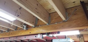

Friday I brought home a piece of bowling alley lane and got it mounted up to my large base I've had against the wall for about size months. Makes a great workbench.
Today I cleaned some more. Last night I also picked up eight LED lights at Sam's to go under the add-on. It was dark under there and these do the trick. They are actually adjustable between 3000k, 4000k and 5000k. They're also linkable up to four lights. I do a lot of audio and remote start jobs under this part and these lights will be great. I wired up two outlets so that I could plug each set of four into.
I then set my sights on getting that railing up. I'm going to have about 40 kids with parents through here tomorrow and I need to get that done most importantly. 7caa159ccb703103e4198b9b028b2841.jpg72f134dab0ed0e36423614bfcebef15e.jpg30e5a28568aac782650bf74356b39b75.jpgca3af531ee9aeb66d410fd40c3c2bcce.jpg876c3094e58a71ad617a6cbe7fc9c584.jpg47370612a278cb68e85b9d94c5cb6110.jpg879a9bcea298396f2fb72ff9e1971a5d.jpge50b1f144a1650746cf32f52ca8a2027.jpga534ef9a86b4d6747e6490eab1c5f4fa.jpg57378ca026c21af2d865e23c97120ea2.jpg92adbc509b786bf002819e55f9a17a0e.jpg0e9c548267c716e3d9681e509a8d555f.jpg810f7ba7f0fbb932fd364d6b7e257332.jpg2f2e5affcfd49bef13ff1490d1a32faa.jpg1f1f8df13428be294bb129b75fb9c677.jpg9a1ef233349548ee8c9900fbcfbfa0fc.jpg09c366ef3f89161ac259f8014cb6024b.jpg9a7770804281731ea577d65872205f54.jpg7d6fc433283f41e6143b70e724f5fcbc.jpg808c74147b00f151c269e19117ea58ab.jpg31009360c48a53b667dea44b90ea68d3.jpg77df7d325f20f7c4b5add5aa0aaab885.jpgf4acfeeb11745653b286cb5946758feb.jpg

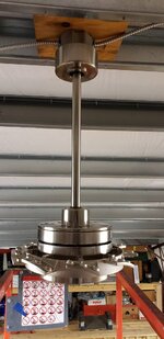

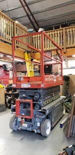

A little update. My wife surprised me for a early Father's Day gift and had my Peter Vitale table put back together. It's been in storage for 7 years. It's coming together slowly. ef340ab0c4cd600eb64e76b776394a9a.jpgbb9278c47efa2f0ae13a5bb0c34eaf25.jpg3dca645afcd31ef464b5eddd5bcdd693.jpg239869b4190ea6b1c2091ce95f2b3b74.jpg90036305d69ef733fdfd192b77325234.jpg1f24e2ef34b73a4decbb794986a7d1bf.jpg1a483ffd8bab326f1ac5169cd5aa3938.jpg8f100876024c5a1f7c6f18c53b54cc1a.jpge14b844b2469116a0db6c8bf09641cb7.jpg

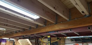

Well I finally started on my build. I got all the lumber and everything back in November but could never get to it.
I've actually changed the design to have the stairway further back.
First challenge was to cut the notches out of the 6x6 posts. I found it easier to just feed them into the band saw and then cross cut the notches out with the circular saw.
After getting four posts up I bolted the 2x10 beams to them using Thrulok fasteners which are awesome to use. It's nice building it in 10 foot sections.
Next came the hangers and 2x8 joists.
One section done.
Tomorrow I should get more accomplished now that I've gotten the ball rolling.
When in doubt, make it stout!!

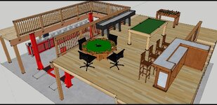

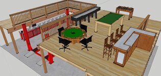

Thank you so much for this thread! I found it just as I was starting to design my mezzanine in my Worldwide Steel building. I was able to learn from your 'evolution' and incorporated a lot of your design into my final layout. My building is 30'x50' and I am building the mezzanine in the rear of the building, for a 30' by 14'-ish mezzanine:
