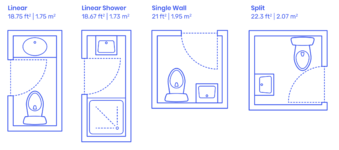

Last minute delima. What’s smallest shop bathroom size I can get away with for a sink, and a toliet? Will have slop sink mounted on exterior wall outside of bathroom for main cleanup

Skip the sink. ******* only needs about 32" wide 48" deep if you do an out swing door.
If you want a sink, add 24" to width.

Yep, skip the sink if you are adding a slop sink outside the bathroom.
3x5 seems like it would work, but you will need to go outside to change your mind!
Depends on whay you want to use it for. Bathroom duties only? Then 3x5. If you will be changing from work to street clothes you might want more room.

Seriously though. What is up with making bathrooms tight? I'd never do it. Also, you need to consider the space you have available and what makes sense. That said, here are some guidelines.

With a similar thought - appropriate size if including a corner shower? nolimits76 - those sketches are helpful!
In my shop planning, I'm thinking similar to OP, just with a 36x36 corner shower added. Toilet+sink. Slop sink outside of bathroom.
I don't want the absolute smallest Tommy Boy bathroom, but like some other commenters, I don't want extra bathroom storage space.

Mine is roughly 5x10 feet with a *******, 4ft counter top with sink and also has my well panel and a small pressure tank inside. Probably didn't need to be quite that big but it just worked out that way. Plenty of room to change clothes or anything like that if you wanted or else hold two women when we are having parties (since women cant go to the bathroom themselves for some reason)
Friend of mine has a bathroom that I would say is probably 3x6 and has a ******* and a 2x2sink in it. Barely enough room to open the door. It is pretty cramped.
stick70
Jun 24, 2014
38
I tried to do 4x4 since I have a house bath that size. Turns out the sink and the toilet drains were too close for code. Ended up at 5x5, square made sense for the layout of the building.

Yea, I think 5x5 would work for a half bath, but add the corner shower (which looks to be 36-38" radius from the corner. Then what? 5x7? 6x8?

My last house had a 5x8 master. Toilet, 30" vanity and 42" corner shower. Door had its own dedicated space, but an out swing would replicate that.
Enough room for activities, for sure

I think the toilet and sink opposite each other is probably the most-narrow, and most practical use of space. We just did that for a half-bath in a laundry room, where a partition wall separate the W/D from the half-bath.

If you are looking for the minimum I'd do a 3'X5' toilet room with a pocket door. Since that means you will have water and sewage for the garage, I'm assuming you will also have some kind of deep sink, either a stainless restaurant style or a laundry tub in the garage. Do your hand washing there.
