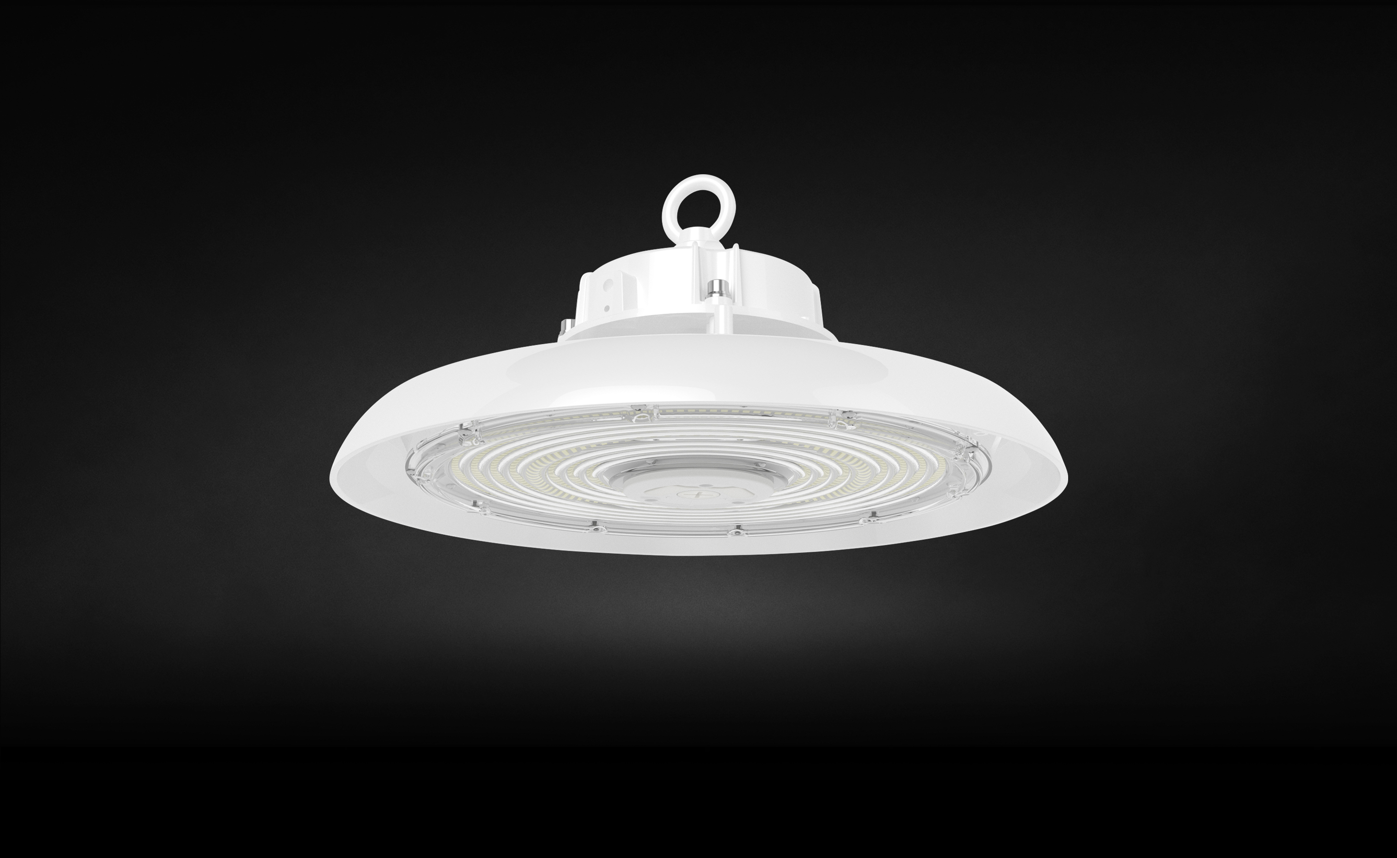

I ordered:
8-RAB H17XL LED-high bay.
2-RAB Wall pack lights

Great choice on RAB lights that’s what I just put outside for floods. For decorative/functional lights check out Steel Lighting Co. they make some really nice barn lights!
