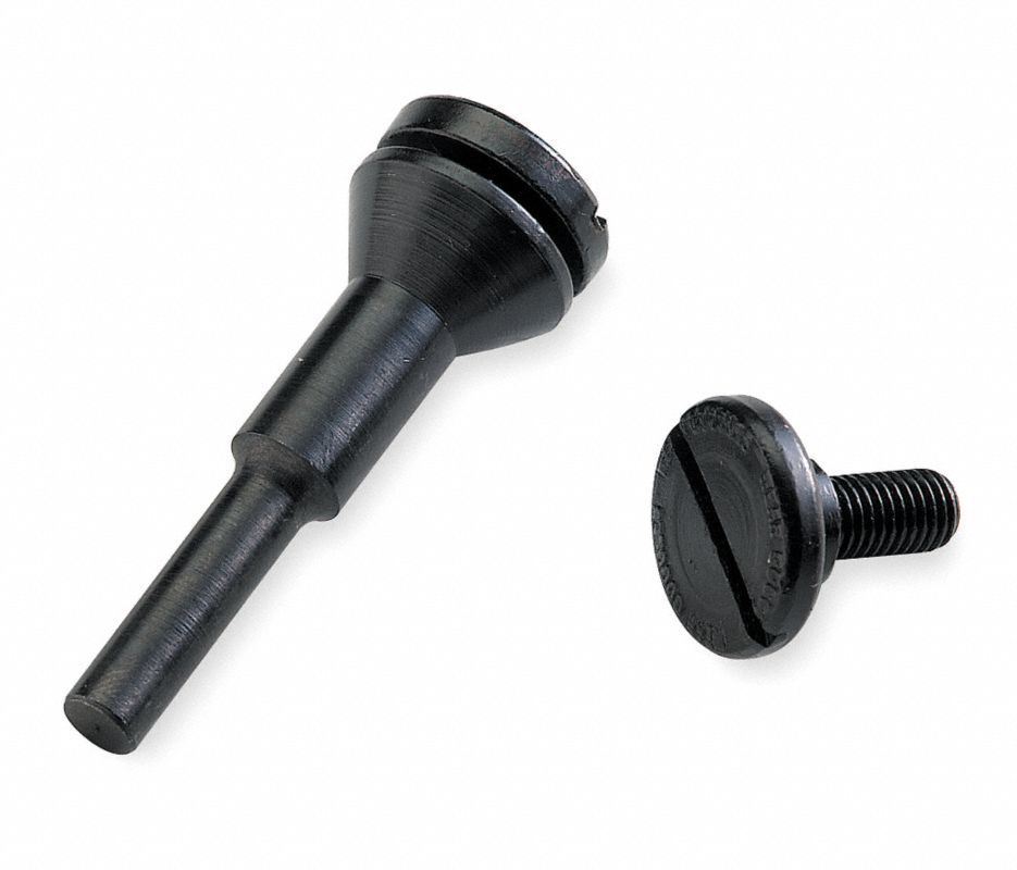

The following shows my process for grinding welds and what tools are used. The first step in cleaning up the weld, I use a 3" x 1/16 cutoff wheel, shown here in an angle die grinder. (the angle die grinder will get into some tighter spots than the straight one)
By using the cutoff wheel to grind, you have a contact patch of about 1/16 x 1/4. Comparing to a flap disc, for an example, which has a contact patch at least 4 times that amount. The more contact area, the more heat generated, for more of a chance for additional shrinking. The cutoff wheel also has a less obstructed view of the area to insure you don't go too far in grinding or inadvertently hit the parent metal to the sides of the weld. Next, just like using a drill bit, let the abrasive tool do the work, you don't need or want to lean on it. Also, I don't waste my time with HF or swap meet cut off wheels. If you've ever used them, then you have seen the brown haze they leave in the air as they quickly disintegrate. I prefer to use premium cut off wheels, rated for stainless steel. I have used Norton, Sait, Metabo, etc., but they all are rated for stainless or I don't buy them. Cost more? Sure does. But any extra spent on the premium product is more than made up for in less changout, less brown haze, longer abrasive life. Here is a thread I did on showing the grinding process, rather than me write it again... :bounce:
I had a request to explain my process for grinding down the welds, so here goes. It's kinda hard to take pictures and grind at the same time, but we'll do the best we can.
I use a 3" cutoff wheel, 1/16 thick, and hold it perpendicular to the weld bead. I work this back and forth along the weld bead, covering about a 1/2" area. Don't sit in one spot or it will tend to cut and not grind. next, if we just stayed in the center of the weld bead, you would wind up with a concave depression in the middle of the weld when done, so make a few passes down the middle, then work toward one side, then the other, in attempt to keep what you are grinding fairly flat. Try to stop when you are just above the surface of the sheet metal, or otherwise you will have grinding gouges, like some of the ones shown here: :mad:
This takes a bit of patience and finesse (something I'm still working on), but getting rid of the bulk of the weld in this fashion seems to make the sanding discs last quite a bit longer. After the welds are down to a workable level, switch to the 3" angle sander, I use a 60 grit sanding disc.
Next, once the bulk of the grinding is done, the next step will depend on the shape of your panel, or how far in a tight corner you are..
All of the tools are held by hand, no jig, but use your opposite hand to form a "tripod" to stabilize, or rest the other on. Use gradual, consistent, motion to get consistent results. Again, let the abrasive do the work, no need to lean on the tool...

I use the same technique for dressing welds (learned it from you), except I use a thinner wheel in my 4-1/2" angle grinder. This is far from an ideal situation due to the size of the wheel and companion guard, and also that you can't control the speed.
I was thinking about converting to your method with the cutoff wheel in the right-angle grinder, but I wasn't able to find a mandrel.
Where did you get the mandrel to attach the 3" wheel to your angle grinder?
Interesting about stainless-steel rated. I've not been paying that premium because I'm not working with SS. Hadn't thought about the quality of the product being better. Lehigh Valley Abrasives says the difference is the SS-rated products don't contain stuff in the abrasives or in the bonding agents that contaminate SS, so I figured what's the point.
Now I know different. Next time I buy cutoff discs I'll make the jump - the price differential isn't that bad.

Can't remember where I got it from, but this is the one I have, one screw is straight 1/4 shank for the cut off wheels with 1/4 holes, second screw has 3/8 shank for cut off wheels with 3/8 holes. Arbor piece has 3/8 relief cut in it for the larger shank bolt.
http://www.grainger.com/product/CLESCO-Cut-Off-Wheel-Mandrel-1F544
****edit....just went to Tractor Supply, they have the same style for 5.99
