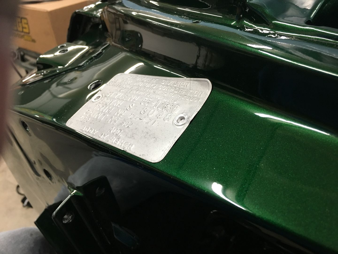

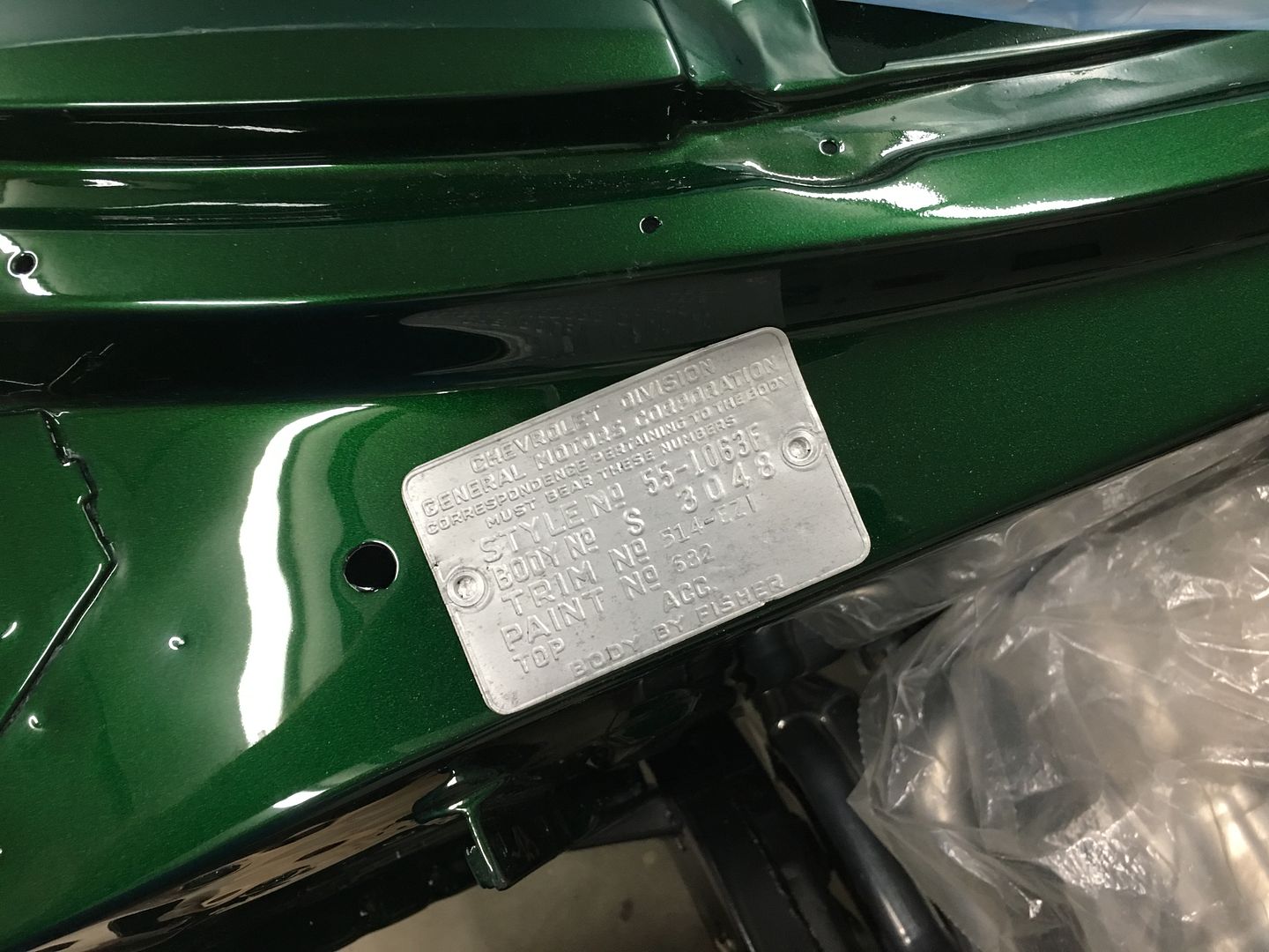

MP&C
Oct 21, 2009
4,419
Leonardtown, MD
Ours had this slight crease at the top right, and since the owner helped with dis-assembly, I thought perhaps it was from trying to pry it off.
Installed it last night and it now appears something that was done at the factory, as it doesn't exactly fit well... So we used a more matching radius over folding the hard crease..
larry4406
Jan 27, 2006
20,291
Northern Virginia
Robert - On E-body Mopars (yes I know yours is a Chevy) the data tag was fixed to the body using the rear screw, then bent up creating the bend line (hinge) so they could paint the inner fender under the tag. Later the data tag was bent down and the 2nd screw attached. Thus one screw painted and one not with a crease in the tag.
No clue what Chevy did.
