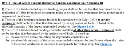

Its sized correctly even when the ungrounded conductors are oversized?

Table 16A in the CEC specifies the size based on the ungrounded conductor size. Cables are made accordingly.
Thread with discussion and the table:
https://www.electriciantalk.com/f31/table-16a-268842/
Not what Im referring to.
Heres an example.
Lets say a circuit needs #8 ungrounded conductors. But due to voltage drop, the conductors need to be sized to #6.
The EGC in cable assemblies is #10 for #8 and #6.
But because the ungrounded conductors were oversized, that #10 needs to be upsized. With a premade cable assembly you cant do that.
I think it is. #10 conductors get a #12 bond/EGC per table 16. Doesn't matter if its in a 20A or 30A circuit.
Here's the 2018 CEC: (3a and 3b most pertinent)
