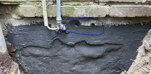

1. Small water issue.
1.13 Protective layer, back-filled & finished.
For the last time (for this project), setting up shop.
Fitting the protective layer. Those studs are approx. 1cm/ 0.39” and face the wall/ sealant. This way air can circulate/ moisture can dry. If you expect lots and lots of water, you’d install it the other way around, studs facing the soil.
Backfill.
As you can see there is one damaged clinker brick, I found the missing piece and re-installed it.
Re-mounting the hose reel.
All done.
Thank you for being part of the journey!

I’m guessing even though those two holes are above the soil line that you still filled them before finishing the job? Otherwise bugs and spiders and maybe a few other things can get inside your basement.
Very nice work with all the repairs and thought process and especially how you involved your neighbor and dealt with the professionals.
Well done sir!!

Thank you very much @drivesitfar ! Honestly, I didn’t fill the two holes. They go less than 4” into the concrete pad, it’s a dead end. I thought about filling them when I had my mortar mix ready, but then I didn’t want to get my injection gun for this. … And just some putty over it is still just some putty over it. … ;) Now the protective layer covers them and that’s it.
Kind regards,
Olli

I wa concerned that the upper two holes went thru to your basement so it sounds like your repair should work great.

So I have a couple of projects going on, and yesterday I was stashing away shop supplies when my eyes fell on a new spot damaged by moisture/water. This is a bit further down from the corner, and it means there must still be water building up between ours and the neighbor’s house.
Red circle marks the area. That picture was taken months ago when the whole saga started, clearly no damage back then.
Now I’ll have to decide how to proceed. As I have enough on my plate as is, without this additional project, I think this is something for ‘26. Not going to deal with it over the holidays if I can help it.
But this nicely illustrates that opinions, experience and even measurements/data are just that.
