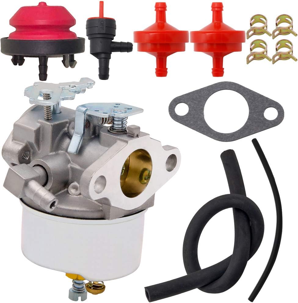

I am digging up this old thread because I am looking to buy a carburetor for a snow blower. I am going to try one of the cheap Chinese ones from ebay.
I am one of those people that does NOT think they are all the same. But I am OK with taking some risk.
Does anyone have any tips or tricks on how to pick a good product or good seller?
If it matters, the carb is for a Troy-Bilt Storm 2410 snow blower with a 179cc engine. It's made by MTD and is about 5 years old.
Thanks for any suggestions.

The snow blower model number on a sticker on the snow blower is:
31AS62N2711
There are a few places on the engine of the snow blower where the following number shows up. I think it is the engine code/type:
265-SUA
The manufacturer website (MTD) shows conflicting information for the correct carburetor. I think the following is the correct part number. I plan on comparing the manufacturer website pictures to the carb that is actually on the snow blower. But I have not gotten a chance to do that yet.
951-12705
Plugging that part number into ebay's search box with the word "carburetor" currently results in about 200 results. I don't think they are all different, but I don't think they are all the same. I'm not looking for someone to pick one out for me. But I am looking for ways to distinguish good carburetors and good sellers from bad ones.
Thank you for any help you can provide.

This is who and what I'd probably buy. https://www.ebay.com/itm/CARBURETOR...041409?hash=item3afc0137c1:g:j8EAAOSwqBpaTPFx
I just searched and I've purchased from that seller twice over the past few years. One an unloader for my powerwasher and the other a deck cable for my riding mower.
Joe Mamma
May 31, 2009
339
Just based on a quick comparison, the ebay one looks a little different than the one on the snow blower. I noticed the fuel drain screw on the ebay one is just a hex head, but the one on the snow blower is both a hex head and Phillips head.
That being said, I'll take my chances. I appreciate the link and you sharing your experiences with the seller. I just placed an order for it.

get one with adjustable main jet if you can .
What you really want is one with an adjustable idle/primary/pilot jet (same thing; different people use different terms). These have not existed in over 20-30 years !
Finding the idle/primary/pilot jet on some carbs is a challenge ! Many are hidden under a difficult to remove plastic piece. Some are even under a metal Welch plug.
Most carbs, including replacement, are set up for a very lean idle. Because this is also the primary jet, the main/secondary jet can not supply enough fuel. The engine starves, starts to stall and the governor kicks up the speed so the engine speed surges/oscillates up and down.
One guy on YouTube goes so far as to disassemble the carb, remove the idle/primary/pilot jet, using number (NOT fractional) drill bits determines the existing size and steps it up by about 2 numbers.

Following up on my posts above, I ordered 2 carbs from the same seller at the same.
The two I received are actually a little bit different from each other. At least one of the screws is different, the primer hoses are different (different inside and outside diameters), the gaskets material is different (but very similar in shape), and even the cast aluminum carb bodies are slightly different (which surprised me the most). The more closely I look, the more differences I see.
To be clear, I am not saying the 2 carbs are just a little different from the original carb on the snow blower. I am saying the 2 carbs I received from the same place in the same order are slightly different from each other.
I am guessing they will probably work (or some combination of the parts if I swap them out). But I wasn't expecting 2 from the same order to be different. The part numbers on the outside of the boxes are the same.
I would still probably order them again.

Ladyfriend of mine was given a 5 year old Troybilt riding mower w/B&S 13.5? HP engine last year. I think her other friend simply buys a new one every 4-5 years and does nothing to them in between.
Anyhow, after new blades, air filter and prefilter, and it's first oil change, it ran fine a few times. Then she got a crankcase full of gas. Common with these gravity fed Nikki carbs which are similar to the OP's, though a different model.
A kit did not fix that problem and I can't see why. Read that is a common occurrence so I got a new ChiCom knockoff. It fits well an looks identical at a glance, but side by side with the old one, there are some small differences which indicate a different manufacturer.
New carb doesn't leak, but it wouldn't idle properly: severe surging. Adjusting idle mixture screw did nothing. Checked for vacuum leaks and seemed to find one, but torquing the mounting nuts didn't make much difference though spraying carb cleaner indicated no more leak.
Finally took a piece of wire and checked the passages. The ones for the idle circuit? from the air intake side and fuel (bowl) side were not drilled through. Bushings seemed okay though. I might have drilled the fuel side, but I can't drill the intake side.
I had selected a seller whose ad stated for factory defect: lifetime warranty. Took an extra message to convince them this carb is bad. They finally told me to order and pay for another one, then they will reverse the charge on the newer one. Am now waiting for the newer one. Hope it's good and they reverse charge, and I can give them a good rating. We'll see.
Point is they're no't exactly the same. If one works well, it doesn't matter and you save money. If it doesn't work well ...
When researching these carbs, some don't even have idle mixture screws so watch out for that. Also warranties/returns vary widely, so you might want to consider that too.
CA compliant carbs often seal the adjustment screw under a welch plug.

I have one on my similar aged Snapper 1030. Also a Tecumseh engine. Works great.

I have a Snapper 1030 snowblower too. About 4 years ago it developed a problem that I was able to isolate to the carburetor, so I removed the carburetor and had a local shop rebuild it for me. It cost about $65.00 total. I reinstalled it and made the proper adjustments, and only used non-ethanol gasoline in snowblower from that point forward. It’s been running like a champ ever since.
For future reference can you provide a link to the carburetor that you purchased? What did it cost?

When I installed the Chinese carb I also installed a fuel shutoff valve. When I’m done using the machines I shut the fuel off and let it run till the carb is empty. I use 10% ethanol regular fuel with Stabil.

Put a $15 china carb on a 7hp tecumseh snow thrower engine, some tuning and it runs again with minimal investment. Turned a trash picked junk snow thrower into a viable unit for about $35 or 40 bucks between a carb and 2 new tires, Gf's parents bought a new larger property this past year and it was a great "housewarming" gift. Spent a bunch of my labor time tinkering, but who cares... something to do while chilling at home and having some brews.
