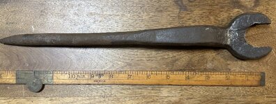

I have I guess what is an old valve wrench with what looks like a "Z" in a circle. Can't find this logo anywhere. I'm assuming it would stand for the drop forge company? The opening isn't a true square. Also has what looks like two overlapping X's. It's a mystery to me.
Hi. The "overlapping X's" are a W and an A.

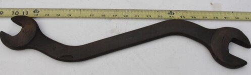

I'm looking for the definitive identification of this logo: a keystone with PS inside. I'm thinking Pennsylvania Steel, but this is only a (somewhat educated) guess. Anyone? Examples here are a W&B "S" wrench and an unknown spud wrench, both stamped with the "Keystone PS" stamp.
keystonelogoS-wrenchdetail.jpegPSkeystonelogo.jpgKeystoneSpud.jpegKetstoneSpudDetail.jpeg

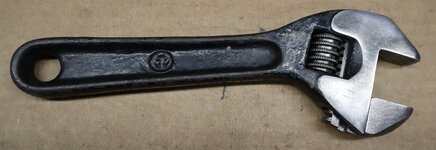

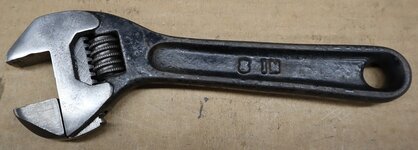

Oswego / Oswego Tool Co., 119-27 W. First St., Oswego, NY / "Giles Patent wrench" / patent 391957 Oct 30 1888 J.A. Giles / http://alloy-artifacts.org/other-makers-p2.html#oswego / https://www.vintagetools.net/product/oswego-tool-co-8-inch-stilson-wrench-561pc / http://toolarchives.com/node/253 /
I think I have a Oswego Tool Company wrench. The only logo is a circle with a "T" inside. A similar logo was used by Osaka Tanko. This wrench is 8" long and is also marked with matching numbers on the jaw and wrench. It features a easily removable adjuster. Simply unscrew the jaw and then the adjuster can be moved to the side and lifted out. I have a 1920 ad showing this feature on a "S" wrench. Cannot locate any straight wrenches with this feature and logo. Any thoughts on if this wrench is earlier, later, or same time as the "S" model?
