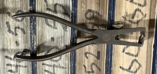

Knipex No. 11 Wire Stripping Pliers. I came across this tool today.

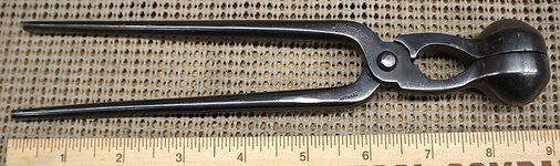

Not sure about these. The seller called them seaming pliers. They are marked "GERMANY" and a word I can't figure out (second picture). They are about 9" long. The head is somewhat ball shaped with flat gripping areas about 1" across.
Received information from one of the companies:
Mintgrun
Oct 7, 2015
2,141
Kingston, Wa.
The top of the A is Above the flAt side.
Based on that listing, Giesen & Forsthoff may have been the manufacturer of your pliers, but a quick search shows scissors and razors, not pliers.
Oregon Dave
Sep 16, 2023
298
Mintgrun’s Adoration looks like a match to me.
Seaming Pliers? Typically are use for sheet metal state-side; maybe those are for fabric. One thing for certain; the ball end and open space between the ball end and pivot are for a German reason; very practical in application.
Eric Brown
Jun 14, 2024
678
I agree with your Adoration. Now as to their use, I wonder if maybe these were heated, like a sad iron. Just a thought.
