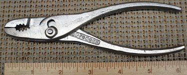

I found these Diamond tools at Thursday’s estate sales and got around to taking them out of the evaporust yesterday. IMG_5259.jpeg
The snips came out looking good and I adjusted the screw and nut to take out the excessive play. IMG_5291.jpegIMG_5292.jpeg
The pliers came out okay with kind of an uneven finish.

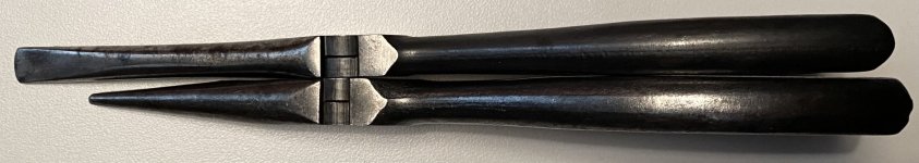

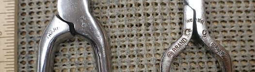

Not sure about these. The seller called them seaming pliers. They are marked "GERMANY" and a word I can't figure out (second picture). They are about 9" long. The head is somewhat ball shaped with flat gripping areas about 1" across.
Found more info. According to some sources these may be for both curling using a wooden spindle and the round clamping area by the "jaws", and also for straightening in the smooth parts of the jaws.
A group of curling irons (pliers). Below that are two curling pliers. One is simply marked France while the other is Acier, C9, Germany, and KB inside a circle next to Brand.

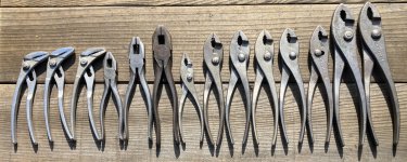

The battery wrench scavenger hunt on the Bonney thread got me looking more closely at wartime Bonney pliers illustrations, which led to noticing two different models (B15 & B537) of side-cutting slip-joints, which is going to lead to a reexamination of Bonney pliers I’ve assumed were Utica production. The apparent grip patterns in the illustrations, some explicitly described as Champion DeArment, has me wondering about that generic-looking Barcalo/Danielson/Crescent knurl/diamonds pattern.

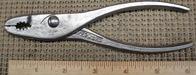

Here are a couple I could use help identifying. The one pair only has Drop Forged on both handles. No other markings and plain handles. The second pair is only marked with a couple triangles with a dot in the middle.

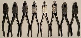

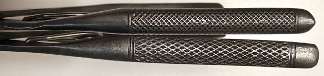

I was looking at Alloy Artifacts’ PS&W linemans pliers, which they credit to Utica, based on the nearly identical grip pattern. This has bothered me off and on, partly because I have bought rusted box joint PS&Ws thinking they were Utica, and partly because I thought I’d since learned to distinguish them.
PS&W handles are generally heavier, and the depressed diamonds grip pattern (when present), always has a V-terminating top and never has a speedbump at the bottom. Uticas usually betray the remains of a lower speedbump, even when it is mostly polished away. IMG_7913.jpeg
(top pair above is Utica)
Further, the head is more like Utica’s lighter No50 than their heavier No1950, but always has a flat-walled (hexish) well for the cutters, whereas Utica 50s always have a round well and Utica 1950s always have the hexish well.
(PS&W at top, above, Utica at bottom)
(all PS&W)
The PS&W cutters are almost always on a convex surface proud of the rest of the head (I have one that is flat flush), while Utica cutters are almost always flat flush (I have one that is convex proud).
(all PS&W)
Most PS&W pivot pins (both lap-joint and box-joint) have five flats locking them - I have not seen this detail on Utica.
(PS&W above)
Lastly, Uticas of the era with V-terminating grip pattern always have a forged-in 3-diamonds logo inside the handles (or shadows if highly polished), but PS&W examples don’t, even when other forging marks remain after finishing.
(Utica at top, above; two PS&W at bottom)
I’m not arguing that AA is necessarily wrong (surely, there’s SOME reason the two grip patterns are so similar), but to me, the preponderance of evidence of every other part of the pliers suggests their conclusion should be phrased in more tentative terms.
Not to walk back that criticism concerning Utica OEM evidence for PEXTO linesman pliers, but I thought I should apply some of it to Bonney linesman pliers, with uncertain results.
I have three pair of Bonney linesman pliers, and they are apparently all from the same era and mfr. I have assumed they were Utica-made, but there are some problems.
The heads are identical to neither Utica’s heavy duty no1950 nor to the lighter no50. Like the PEXTOs, they combine the hexish cutter well with a slender head, and the outer facets don’t exactly match either Utica form.
On the other hand, I have one ca1955 Bell System linesman pliers clearly marked Utica, which has the New England head style popularized by Klein, so differing heads for different contracts were obviously within Utica’s wheelhouse.
Looking at 6” Utica linesman pliers across a wider range of production eras doesn’t provide any better matches. IMG_7979.jpegIMG_7977.jpegIMG_7978.jpeg
From these comparisons, I think the only obvious conclusion is that I must buy more Bonney and Utica pliers!:ROFLMAO:

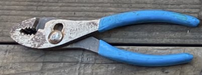

I know your point was to hypothetically emphasize their indistinguishability otherwise, but they would almost certainly have the Champ D arrow flight pattern if Champ D. But now I have a left field question for you. I don't own too many Bonney pliers, but of those I do, all of the pivot joints (dykes, needle-nose, etc) are sourced from Utica (smooth handle) and all the slip-joints are sourced from either Crescent or J.P. Danielson. Do you have ANY Bonney pliers made by Champ D? If so, they have the arrow flight pattern grips, right?
Oops! I missed this post, and I thought I had included this photo, showing that Channellocks sometimes have smooth handles (smoother than I’d assume the blue dip coat conceals).
Looking hard at the Bonney cat illustrations, I don’t think the broad arrow flight pattern is depicted, and certainly not well-described by “knurled.” Maybe the earlier, reedy-looking narrow arrow flight pattern (I don’t have any examples), but I still balk at “knurled” describing that pattern, either.
Bottom line, I do not have any Bonney-marked pliers with the arrow flight pattern, nor any co-branded Champ-D, so I don’t really know if I have Bonney pliers where Champ-D is OEM. What I do know is I have some smooth-handled Bonney pliers that I have assumed were Utica-made, but now I’m not so sure.
For example, these two -
IMG_7988.jpegIMG_7990.jpegIMG_7989.jpegI have no Utica dopplegangers of them. I have multiple models of Utica sidecutter longnose, all with round cutter wells, and none with hexish wells. I’m thinking Crescent for both.
On the other hand,
IMG_7992.jpegIMG_7991.jpegdespite being almost identical, it seems clear to me that the Bonney self-gripping pliers in this sandwich are Utica, not Channellock (all smooth grips). The “pat. apl’d for” indicates Utica’s US2622464, the forging process, not Channellock’s US2592927 rib pattern (both Utica and Bonney retain that), nor US2640381 imoroved rib pattern.
30,660
Channellocks sometimes have smooth handles...
Yes. But if they have a grip pattern, it's only the early or later arrow flights. I've never seen Champ D pliers that weren't smooth or one of those patterns. I guess what I'm saying is..., I took your point to be purely hypothetical and rhetorical. You think the Utica and the Champ D combo S-J's with the ****-like side-cutters are so alike that if they were Bonney-branded and had the same grip pattern it would be hard to identify the OEM.

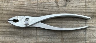

Okay, here are the Barcalo handle pattern results, Part one. Tools in the basement will be part two.
Border lines at either end of the patterns.IMG_5386.jpegIMG_5385.jpegIMG_5384.jpegIMG_5387.jpegIMG_5388.jpeg
